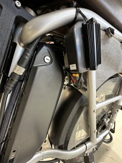

First, I've updated my wiring chart to include the rpi; a new 5v dcdc that can be shared between the pi, dashcam, and potentially other things down the line, I suppose.
I also need to upgrade the rear electronics storage area; the aliexpress dime-a-dozen controller bag was simply out of room for stuffing in wires and components, and tbh, I wasn't super happy with how haphazard it was.

Finally, I'm going to take this opportunity to swap out to some thinner wire for signals/power going from the bag to the front -- 16awg was insanely overkill, especially now that I've measured all the power draw devices and found that not a single thing pulls more than 1A at whatever voltage it runs. Plus, most of the wires are signal wires.

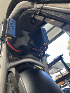

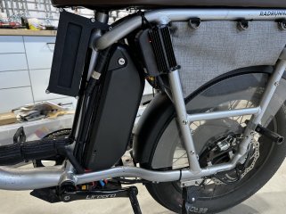

I got it all mounted and stuffed in the bag. Still can fit an air pump, spare tire, tools, and even some handlebar jack stands.
I did find, however, that putting the GPS for the rPi inside that bag with all the other electronics was...unwise. It's odd; the LTE/GPS tracker I have has no issues getting signal and doing it's thing, but the rPi took >20m to get a GPS fix while the bike was outside in a very unobstructed location.
Doing a bit more research, it seems GPS's can be disrupted by being too near other electronics around -- so stuffed into a bag with a computer, another gps, a few DCDC converters and a bunch of signal wires was...perhaps not the best environment. Sadly, I couldn't just pull it out because I'd shortened the USB cable. Oops.

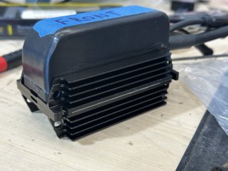

Most importantly, though, I remodeled the rear lightbar carrier on the bike to accommodate a camera mount (to clean that up) and to also hold the GPS unit externally from the bike away from the RF noise part I was hosting in the bag.
This mid-line section analysis shows where the GPS nestles in, it's a screw-cap holding it down, and that the container (as well as the camera mount) both just "slot it" to the light bar carrier. Bolt the light bar on top and it locks everything down. Let's me take the camera/gps off if I need to work on them are replace them with a different "module".

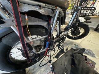

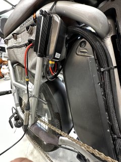

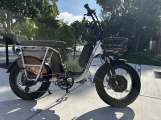

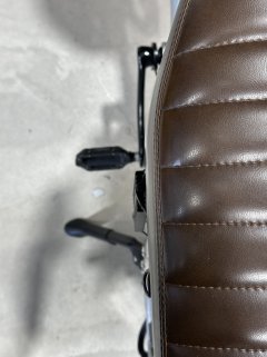

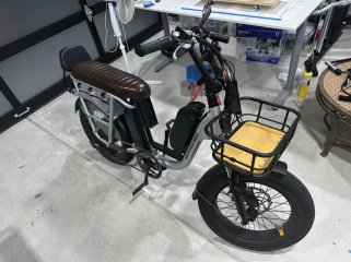

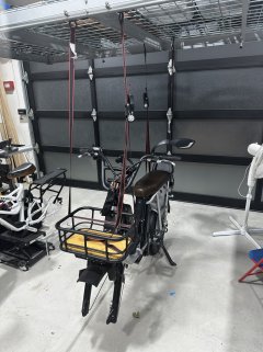

Got some photos of the finished setup today:
Along with the camera/gps mount; and here's the other side of the bag.
It's worth noting that I installed by bag in a ... unique way. Firstly, I could not figure out the "triple d-rings" for the life of me. I understand double d-rings; but these straps had three? Regardless, I wanted something a bit more stout. As such, inside the bag, there is a 3d printed plate with some re-inforcing ally tubes all zip tied together to create a solid top-plate. That top plate is then zip tied onto the rear-rack, under the extended seat. Makes for a super stable setup, and really snugs the whole thing up.

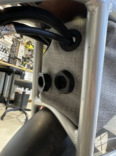

You can see them, but I also 3D printed some grommets for passing all the wires through, since the bag has no openings other than the zipper.
