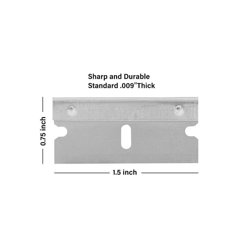

Well the new TA turned up, the flat to flat distance is stated as 10.17mm which I suppose would be alright for an axle with 10mm flats.
However, when I measure my TA distance I get around 10.2mm and when I measure my axle with digital calipers, my axle flats are more like 9.98mm.
Doesn't sound like a lot, but it's not tight at all, it easily rocks back and forth, I can't use this TA.

I break off a small piece of this type of razor blade, which is about 0.229mm thick. I put the sharp edge between the TA and flat, and tap it in to fill the gap. My left side axel is cut slightly narrower than the right, so I only use the shim on that side.

That's actually too large a gap. You want a 10mm (or less, for interference fit) wide hole for a 10mm axle flat width. Any slop means the axle can rock back and forth in it, and that only the tiny edge where the flats meet the hole at an angle are actually doing anything to stop rotation.
E-HP's razorblade shim method can work (I've used that, and other materials, to work with general success).
