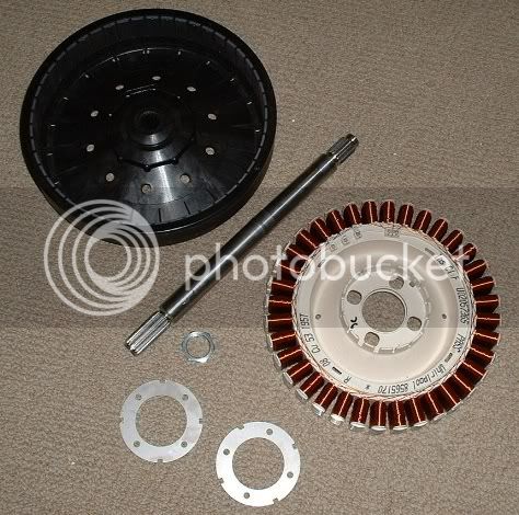

I found a Us distributer who caters to the windmill crowd. $95.00 + shipping for a new motor kit in the photo (no bearings or supports as its a wind mill kit) Very prompt reply to my e-mails & very knowlegable fellow.
If any one can't wait for a scrapper, here is what you get for your money:
shipping to me in the midwest was quoted at $18.00 (way tempting!)

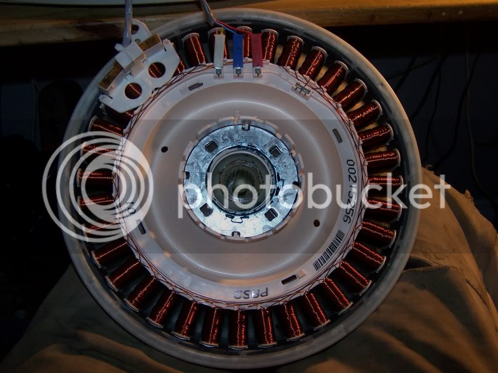

Hi I have been playing with F&P motors for a while,they are a great motor.I have modified 0.6/0.8 and 1mm motors good result with 0.6/0.8 versions.i have run motors @60volt with standard magnets with good power and speed on a BMX style bike with 6 gears to choose from.I have also rewound a motor from scratch,multi strand 0.6 mm wire,have only bench tested motor so far real good RPM with heaps of power.I need to get some NEO magnets to finish off motor.thanks scootinmad.
Excellent, someone else has also played with these F&P for EV motors.
That multi strand rewinding is what I have wanted to do also, would love to hear how it goes, and a great job on rewinding.
I highly recommend going for the neo magnet conversion as it feels like 4 times the magnetic strength. When using them as a turbine I gained 3 times the power compared to ferrites, and also noticed a big difference as an EV motor comparing the two.
The picture in Thuds message looks like it has Neos anyway, but only around 3mm which would be better than the 6mm ferrites, but also means you couldnt use 6mm neos on that rotor, only the older ones.
A BMX is a little machine, have you tested it with a decent load and or direct drive as I got great power directly driving a 27" wheel on a bike also in previous pics on this thread, and you might have seen the vidoes of my EV car with the BMX wheel directly driven and with decent weight will wheel spin very easy.
What is the Amp rating of your controller you have you used??,
I am running 48A at 48V, but can go up to 72V and higher. Will soon try a 18Fet controller.
Are you based in Australia?
The stators do crack a bit, but don't tend to get worse.

That motor is begging to have about twice the amount of copper on it...
Your not kidding . just measured and counted the winding. caliper says .8mm and i can count 30 turns on the outer layer 3 possible 4 layers per stator pole. :eek:

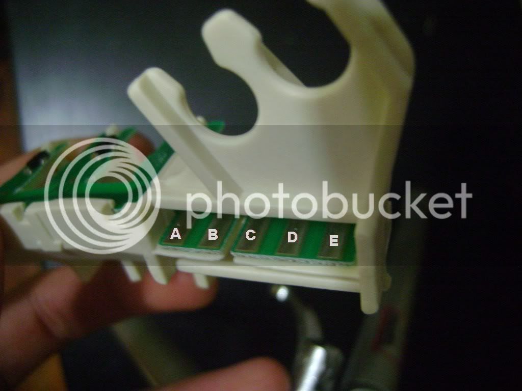

the motor has a hall board built in and i was hoping to use it but it seems the kelly dont like it so ill have to install some halls that i picked up for the "other" motor :evil:
on close inspection it seems the halls that came with the motor have a circuit board with all sorts of things going on . i suspect to deal with ac power or control method its built for .

Yes that sounds like the newer generation motor at .6mm.
How may coils??
You will find that it is designed for high voltage and very low amps at about 1.5A if used as a alternator.
I don't think it will go very well as is but maybe worth a try but it won't draw any usable current at 48V as it is designed to run at much higher voltages.
You will need to re-confugre the windings for high amps & low volts by cutting the wires and re-grouping them as parallel. Meaning all phase 1 coils are in parallel with each other and so on for the other 2 phases.
I just cut every wire between coils and mark them left and right, and then put every left wire of phase 1 soldered onto a ring of heavy copper wire. Do that until you have 3 rings covering all phases.
I keep it simple and use just star, not delta, this means that you can solder all other right wires from all phases to another seperate ring.
This will change everything and should work well with a brushless controller.
The halls are easy to wire in:
Black is Neg and Purple is Pos, the rest are for each phase and you might have to try different combinations to get it working properly like any brushless motor.
I also find that the ferrite magnet rotor is not up to it and I popped them all out and replaced with 56 neo magnets giving 3 times the strength, but another guy has had good results with the standard rotor magnets.
The neos really kick ass over the standard ferrites.

Does anyone here knows the pinouts of the F&P sensor board? I bought this as a spare part at Fisher and Paykel to be used for my EV project so I have no idea what pins go to Vcc, Ground, sensor 1, sensor 2, sensor 3. And does sensor 1 correspond to power lead for phase 1, sensor 2 to phase 2, etc.?
A =
B =
C =
D =
E =
