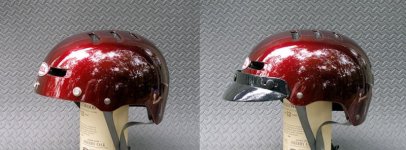

Motorcycle folks figured this out 50 years ago.... :D
Find a helmet you like and pop-rivet three snaps onto it using a backing washer inside (slide washer between shell and foam liner). Then buy just about any motorcycle visor(s) you like - from small sun visors to full face bubbles for the winter. I used SS snaps, but the chrome plated brass ones available in hardware stores will do just fine.
emergence said:
Don't most motorcycle visors have a proprietary flip up mounting system?
(Ohhh - so you want it to flip, too! :D )
Well, yes, they do. But there are always generic counterparts that perhaps don't look quite as integrated but are still pretty nice though.
A quick Google for 'helmet visor flip' turned up this.
A quick search of ebay 'visor helmet flip snap' turns up some pretty good half-face alternatives.
This one looks pretty interesting as well - might be pretty fair quality.
As you can see, we are talking pocket change for these, so you can afford to spring for a couple and just use one that seems the nicest or fits the best.
Generally, the two outer snaps have a slot so the snap can be positioned for different manufacturers' products. I measured the snaps on one of my Bell cycle helmets and it turned out that this was about halfway in the visor slots for two generic visors as well as a genuine Bell visor. So - I used the midpoint position when I drilled. Most important is to test fit so the visor lies flat even if it doesn't quite follow the contour of the helmet edge exactly (you can fudge this a bit). The curvature deviation isn't noticable when you have the visor in place, and it will stop the visor from straining in the snaps. Drill the center hole first and attach the snap there, then the outer snap positioning will pretty much take care of itself.
I used some small stainless washers (hardware store) for backing washers since they were very thin and larger diameter than official pop rivet backing washers. The trick to setting a pop rivet down in the recess of the snap is to slide a small nut onto the rivet pin between the rivet head and the tool nosepiece. This will allow the tool to pull against the rivet instead of the snap. I added a sun visor to a Bell Faction and it came out well. (Not the best helmet choice for aggressive or high speed riding, but adequate if you're puttering along at bicycle speeds...)
I was actually going to post about this little fun project but your post beat me to it :)
Thanks! Just ordered one of those face shields and I'll give it a go.
Would be great to see some pics of your helmet project!
Here you go:
I was planning on the old standby bubble for winter, but took a look at those nice curvey half-face flip-up shields for the rain. By checking things out in the mirror, it doesn't quite look like they'll clear my glasses. I may need to get one of the half-shields with an integral sun visor where the shield comes down from the outer edge of the visor. You got me spending money though :D
Thanks Teklektik! Pretty cool that you can clip on a peak or a faceshield. Looking around it seems like the Faction is a good option for this kind of setup. Or possibly a Giro Flack. The skate style helmets have the flat section across the forehead that this type of mounting requires.
What is even betterer about this setup is that I could actually keep the visor in my bag and just clip it on if it gets super cold, windy or rainy. With a faction helmet the whole setup is super cheap.
The Fingers - I'm talking about face shield visors. Though there is nothing classier than a baseball cap/cycle helmet combo ;)
Yep - the bag o' visors for the weather du jour is pretty handy. If you go this route I recommend getting a sun visor so you can just tip your head down a bit to avoid being blinded as you pedal into the sunset... The one above is a 'Bell 3 Snap Retro Visor' (Amazon, eBay, etc). The generic ones tend to run a little larger, but your preference may vary :wink:
