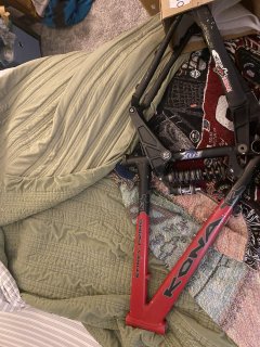

Got the bike frame last night! First off, it's a lot more red than I expected. Lots of scratches and paint nicks, but the welds all look ok.

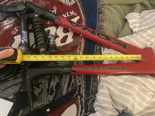

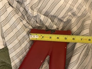

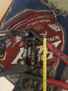

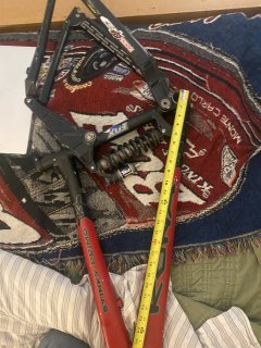

Some basic frame dimensions:
Top tube: shock brain starts ~15" from the head tube welds, top tube is ~18.5" from the head tube weld to the seat tube.
Bottom tube: ~25" from the head tube welds to the opposite end of the bottom bracket, ~23" to the near side of the bottom bracket.
Seat tube: ~17.5" from the bottom of the bottom bracket to the seat post clamp. It's hard to see, but the interior tube to tube is ~12"
Parallel line to Seat Tube: ~9" between the inward-facing sides of the bottom tube and the top tube.
Therefore, I have a triangle about 9" by 15" by 18" where I can fit a battery. I need to make a cardboard template this weekend and measure everything out more precisely.

I’d return it. Battery space is too tiny for a battery that a 4T would need unless you go lipo. What’s going on with those rear dropouts? They don’t look very beefy , and the left looks broken. It there a hanger? Does it support disc brakes?
I might have been able to get away with a bigger battery in a frame that has the shock mounted on the top tube. That being said, a strong head tube that could take a dual crown fork was a higher priority for me than battery space.

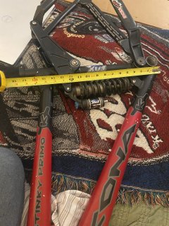

They’re not beefy at all, I agree. Ideally, I’d like to make torque arms out of 1/2” mild steel and use grade 10.9 or 12.9 fasteners. The exact dropout and axle length of the motor will determine the exact specs of the torque arms. The left doesn’t look broken, I had the same thought. Its’s fully painted and my finger can’t feel any sharp edges as if it sheared. I’m inclined to say that’s just how they are.
It there a hanger?
No, but there is a place for one to bolt in on the right.
Yes, the left side has a post mount bracket.
When working with your cardboard battery templates, don't forget to figure in at least minimal dense foam along the edges to protect the battery from vibrations and shock. Highly recommended.
Good call! Is that still necessary if the battery comes in a plastic case and will be stored in a battery bag?
