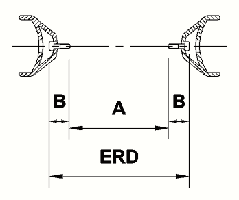

as to the spoke length... i had an :idea:
now that i've got the motor centered, why not just measure the spokes on each side and then add for the nipples. here's the long side (tho a couple are 120mm):
and here's the short side:
and the spokes:
so while i ordered 126mm and 128 mm, looks like i needed (120 + 16 = 136mm) and (117 + 16 = 133mm), or maybe a touch less to account for tightening.
so how the heck did i get so off?
if we know the inside of the rim where the tire bead sits is 19" and subract 2x the groove which i measured like this to get 9mm:
and i also measured like this off the top of the spoke head to get 6mm:
so 19" = 482.6mm and 482.6 - 18 mm (2x9mm) = 18mm) = 464 mm for the ERD from the inside of the grooves, or
482.6 - 12 (2x6mm) = 470.6 for the ERD from the tops of the spokes and...
...this should be an easy web search: how to measure the ERD of a rim, and like rix explained it's the distance between the spokes pushed into the wheel, plus the spoke lengths, so from spoke head to spoke head, as in (let me steal an image):
so let me plug in 470 to the spoke calculator and sure enough:
so at least i know i definitely need longer spokes..
hmm, but i wonder if i can get away with the longer ones 128mm as the shorter ones, which should be 133mm..
why are ebikers so cheap, huh? lol
I thought the Effective Rim Diameter was the rim diameter that the curved side of the spoke nipple seated against. The diagram includes some spoke nipple length :shock:
