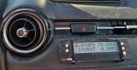

My solution for now is to have less car. Seeing upper 40's-low 60'smpg with regularity on my Mazda 2 makes me happy enough.
Sometimes we crack into the 70's on sundays when i can time the stoplights in suburban conditions.
I'm kinda glad i didn't spend the extra 7k for a hybrid. The only time it performs poorly is in city traffic ( which i drive in ~5% of the time ). That's usually when mpg can dive into the 30's.

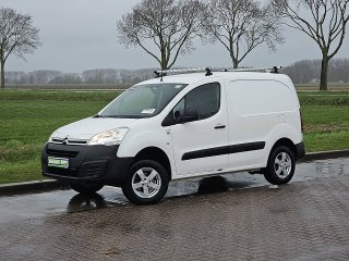

Here id like to point out that such numbers are realistic/practical with diesel engines - the one i'm driving now is a 1.6 liter Citroen van and the overall consumption is around 40mpg, reaching 70 when driving straight/moderate speed (and the car is pretty big for EU standards, almost 10 years old). Unfortunately it seems Europe did some harm to their finest diesel technology, which is bad because it works reliably and is very efficient even without trying too hard.
This is a great result, probably on the border of pure fantasy in the US :)
Yeah, the fuel economy numbers are usually Prius like-for me, but also my driving style is mostly centered around preserving precious momentum... since i have no battery to recoup energy with. So the results are as expected.
My lady ignores 100% of hypermiling advice, will unnecessarily coast in neutral when in-gear is much better, is usually doing 5mph over the speed limit, and still averages 44mpg. About 6mpg avg lower than me.
I'm thinking she could use a prius.
That's a real shame. Europe seems to be dealing itself lots of blows in the energy arena. At a government level they seem to be unaware to the degree which modern civilization and cheap energy are interconnected.
I'm not sure if your country uses the UK gallon but i did a conversion from 70mpg UK to US and it's 58.29mpg.
If your vehicle looks approximately like this, such numbers are outstanding to me. Are you hypermiling such a vehicle or is this just an average day?
