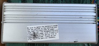

The goal is to figure out what the controller supports that I'm not using yet (there are connectors that I don't know what they are for).

I tried searching the internet for the only number found on the controller (ZHZ48V1000W) and found nothing.

Here is the generic controller:
Anyone know what the mystery connectors are for?

A three wire connector with red, black and green wires if often used for PAS. Under normal operation, connected to a PAS sensor, you'd have 5V on the red wire and 0V on the green. When not connected, I believe there's a pull up resistor that brings the green signal wire up to 5V, or close to it.
Red and black seem to just pass through battery voltage, may used for lights, etc. not sure.
The blue and black could be for a brake cutoff, or things like self-learning or a speed limiter when connected, not sure.

E-HP, thanks a bunch for the swift reply on this, and this is great news because it sounds like it supports PAS, and if so, it stands to reason that the blue and black would be a brake cutoff, and if so, I would expect it to have some voltage on it, so I just went and checked it again and sure enough, 4.7 volts, I guess I just didn't get a good connection with the voltmeter the first time. I'll update the image.

Likely a good guess, but proceed with caution. Also manage your expectations since you can't know what to expect with PAS when there's no way to control the level of assist.
To not re-invent the wheel, here's an excellent explanation of how the brake cutoff works:
https://endless-sphere.com/forums/viewtopic.php?t=104189#p1521396
