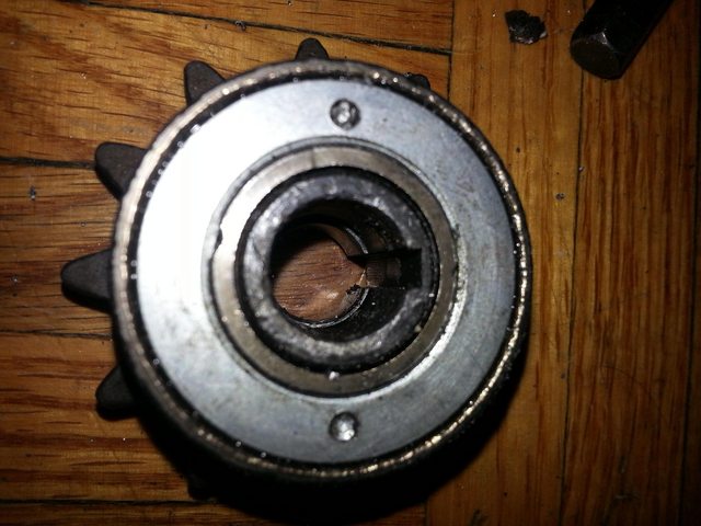

Picked up a gear puller and quickly turned the butter soft jackshaft spindle on the new chain drive kits to this:
Whoops. I stuck the 'nut' back in the hole and tried again, this time it finally came off:
I cleaned up my mess with a dremel and pulled out the new set of taps that I have wanted to try out, and thankfully there are enough leftover threads that it should all screw back together:
Not really sure what happened here but my keyway is looking really ugly, it has been widened from the torque of the motor and has changed the shape of the shaft a bit which is why I guess it was so stuck.
Some pics of the new style freewheel adapter:
It is still a 11mm shaft with 4mm keyway, and it's 10mm long so the staton adapter should work ok. After the 10mm section, there is a ridge and the adapter shaft opens up to 12mm to accommodate the nut that keeps it in place. Not sure why this was redesigned, it doesn't seem any stronger than the original jackshaft and is just more difficult to disassemble.

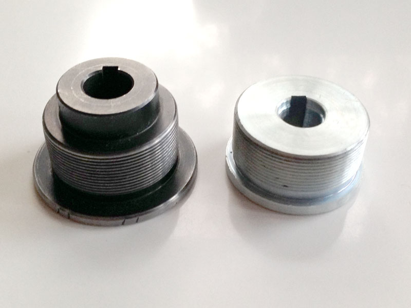

Here's a photo of what I ran into with the Staton freewheel adapter. It's the correct 1.375"-24tpi thread which the GNG adapter on the left is not. You can see the smaller 11mm bore. The problem with using this adapter on a GNG is the missing extension on the back of the hub. It throws the offset on the driven pulley off by about 8mm which effectively puts the pulley inside of the motor case.
The adapters I'm having made should be ready to ship in less than a week. Thanks for being patient while I have these custom made. I just couldn't find an off the shelf solution anywhere.
