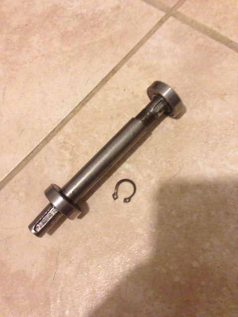

Any idea how to disassemble GNG v1.1 jackshaft. It is metal tube and inside are sealed bearings and shaft. Is it press-fit? How I disassemble it?
At right side bearing seal is worn/broken probaly because bearing does not move and shaft turns inside bearing! For some reason shaft is not tightly inside bearing.
Probably I need to replace that bearing.
I just took my LR jackshaft apart. If it's similar, you'll need to use a gear puller to remove the sprocket and the pulley. Hold the body of the jack shaft and smash one end of the axle on a block of wood. It should push the other side bearing out with the axle. Use the axle again to push out the remaining bearing.
It's literally just this inside the body (axle, 2 bearings and a snap ring)
Thanks. Right now I i already pushed bearing back inside (put flat screwdriver on the edge of bearing and tapped gently with hammer) and now it is tight on axle and bearing started to turn again together with shaft. Seal is still broken but I have it filled with grease and I put big washer to cover bearing.
Maybe later I follow your advice to disassemble it, right now it works as it is.
where is that snap ring located?
