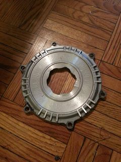

I've seen a few opened up GNG motors on here so someone knows the trick! Can I take pry off either side of the motor with some screwdrivers, or do I need to use a gear puller to slowly push out the spindle side?
Either cover is a mild press/ slip fit onto the shaft/ bearings and center case. No need to remove rotor as the shaft slips out from it also. Just a bit of tapping with the plastic mallet and it will loosen up and come apart easy.

bee said:
This is the part I broke:
Ouch. There is an end bearing for the spindle on the back side of that case. It must have gotten too cocked to one side?
I got mine open without issues but it took some time... On Christer's motor, heating the bearing area with a heat gun helped a lot. I doubled the phases wires on mine just for good mesure at 70A peak! but the best way to get the most out of this motor is high voltage low amps. 100v 40A is more efficient than 50v 70A on this motor.

thanks m8 thats great ,, especially showing how to get the bk cover off,
just a thought ,, would there be any problems if the rear cover had (say) a 10mm hole drilled in the centre so that a pully extracter could push the shaft out before unbolting the covers to remove them ,, im thinking that this way it may take away the risk of cracking or breaking the back cover ??
then on reasembly the hole could be covered ..
