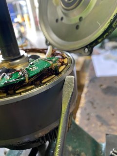

I took her into a shop to get fixed up because I didn't really want to open the hub and mess around. Turns out that's where the problem was and they fixed it. The sensors were pulling away from where they should have been seated. They glued it down but now it's happening again after a week or so, about 2hrs total riding time. I find that I can feel every bump especially on the back so I feel after I move them back down it's going to be a consistent intermittent issue.

If you paid to have it fixed, and the fix only lasted 2 hours, then I’d bring it back. That wasn’t 2 hours at full throttle by chance?
