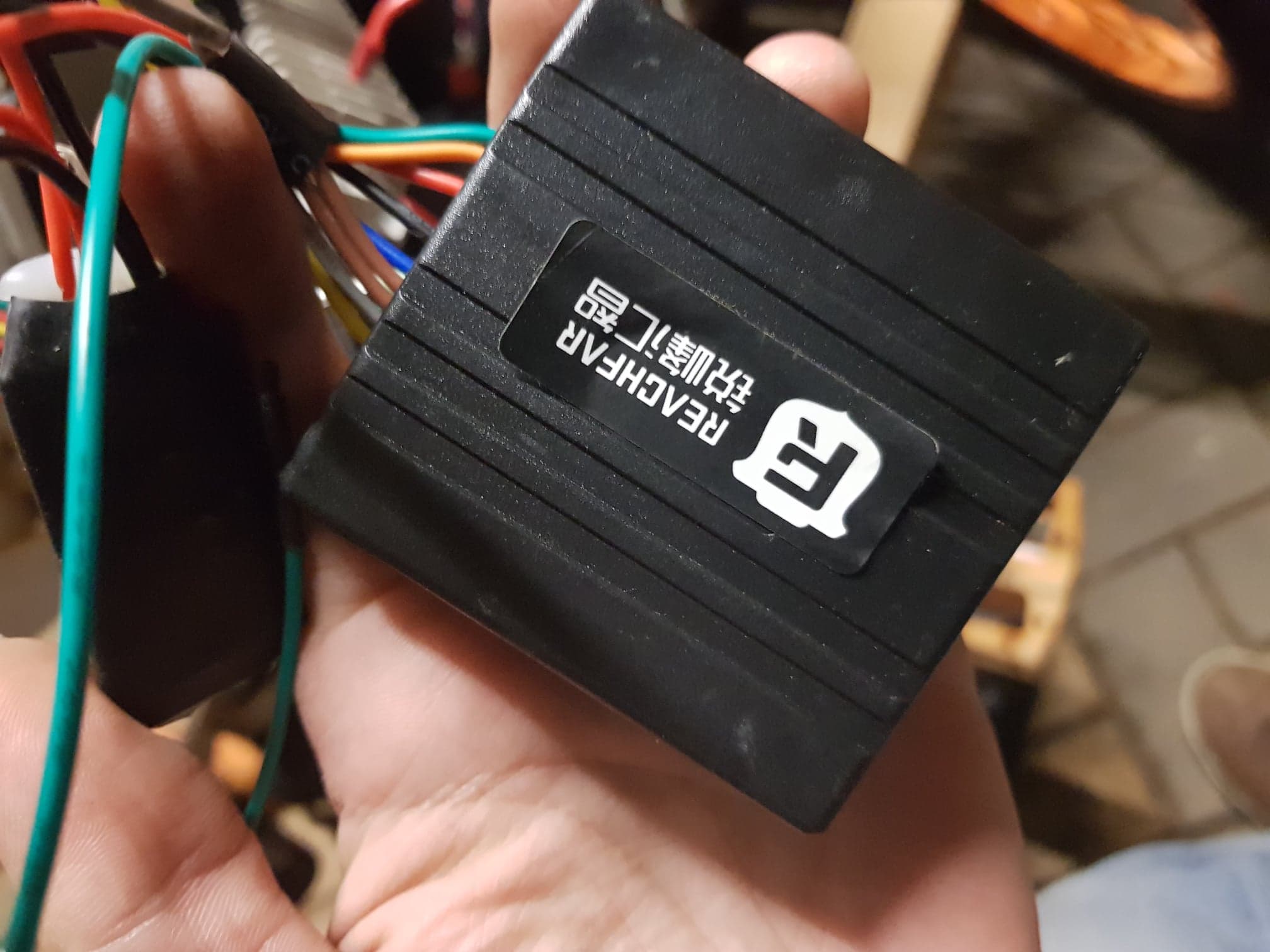

a black module that says "reachfar" which i think is the bluetooth module, though, the two cables that blug into it are labled "alarm" and a gps reciever and alarm connectvinto that black module
ive downloaded the app, hooked it up to a 48v power supply, and nothing?
no bluetooth signal, no wheel movement.
before i plugged the battery in, if i spun the mottor manually, the alarm chirped sadly but doesnt seem to do that now.
any ideas?
the black module that i think is BT feels like its a little warm but i could be dreaming about that
doesnt seem to be any lights or any other signs that its on/off or otherwise

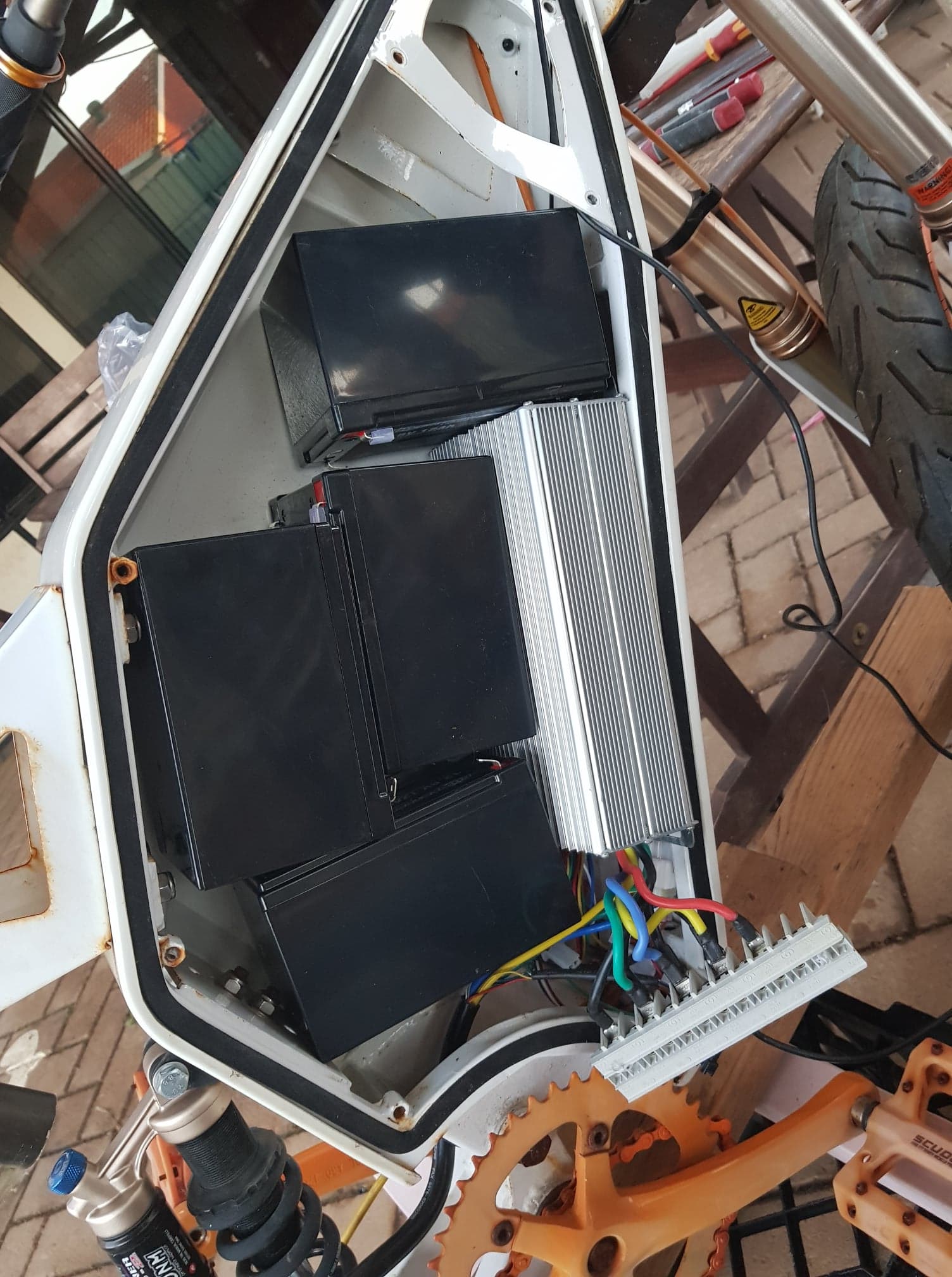

ok, so out the main silver unit, I have:
- Red/black/blue/green/yellow - heavy guage, I assume these are for the motor and power input
green, black, red - labled throttle
blue, black, green, yellow, red - unlabled goes to a connector
dark blue, white, red, yellow, green - labled CA to a connector, im guessing cycle analyst
black and yellow - labled cruise
Brown and black - abled brake
A single red wire with a banana clip fitting unlabled
a white wire that's chopped off and unlabled
theres a pair of plugs that are both labled "alarm"
one is black and red (thes are piggy backed onto a seperate heat shrink wrapped module)
the other is pink brown orange
these both are plugged into the smaller black plastic box
Off the seperate black box theres;
- a grey cable that goes to a connector that has a black and red wire going into the heat shrink wraped module I noted above
- two brown cables to an unlabled clip
- an orange, blue, yellow (which plugs into the orange brown pink on the main unit)
Theres also a green lose wire that looks like an antennae wire
At a guess from noting above comments, I would think to short the lone red wire to +'ve power input?
or maybe the 2x brown terminals?
I cannot find a pair of red wires, any suggestions based on the above??
ok, scratch that above - i nonected the lone red to power and now have a bluetooth connection.
The app says "new firmware available please update" - it doesnt seem to read anything, how do i update?
When i click "update now" I just get a "please try again" message
If i try read in the program or settings it says "oops"

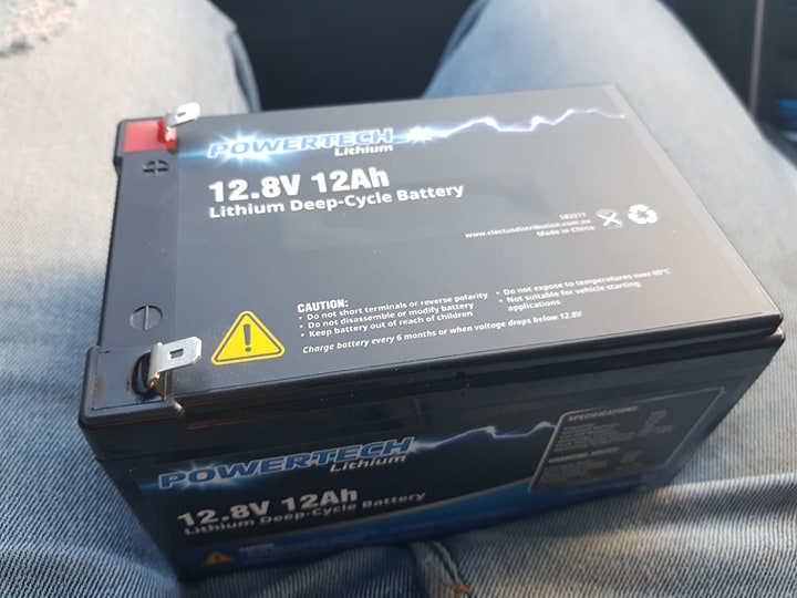

Your batteries: From pics I guess they are in a series for 48v 12A/h. For max 30A supply.
They need to be fully charged, to eliminate as much as possible the possibility that voltage could be lower than controller LVC actual setting. Even then, I hope that you realize that they are not up to the task for the power of this controller. They will run, but settings will need to be lowered to 20A continuous, 30A peak.

Remember before riding. This controller is probably pre-set to much higher power than your battery is able to supply, and this motor can pull a lot of power in hard acceleration. Since your lifepo4 battery is rated only 30A peak, you have to be very conservative in your power usage until you can successfully program the controller to match the limits of the battery.
A QS205 50H with a 30 amp battery behind it? That's not nearly enough to motivate that motor. If it gets pointed uphill it will probably labor so hard it overheats before you reach the top, if it doesn't sap the pack to LVC first.

I added an extra battery pack to make it a 56v setup with 5x12.8v in series based on your observation in my last thread, hopefully this will help with that anticipated problem?
What would you suggest is ideal here? should I be running twice as many packs so that I can parralell groups of two for faster discharge rates, or just adding extras in series as I expand it ?
- I noticed immediately that dropping one of the batteries made it stutter with the default settings with 48v of supply available, wher-as it spun smooth with the 5th pack.

Those batteries are made to replace lead acid car batteries with lifepo4. Their rating is 20A continuous, 30 peak. They are safe and long lasting, but poor performance.

I can get 8-10 in there after unpacking the cases, an extra couple will be quite the squeeze!
Your best bet would possibly be to unload those batteries and get something more appropriate for the task at hand. Barring that, 48v should be fine if it'll get you more cells in parallel. 60a is tenable. 20a isn't worth the effort on that bike imho.
Agreed. If you feed a motor low power as to make it stall up a hill, you are killing it. You want to get out of inefficiency zone quickly.
