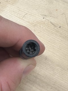

On the bright side, I got some advice on how I can integrate my GPS system into the scooter. They have their own add-on GPS tracker which has a dedicated lead in the front panel area. It also has a nicely placed shelf to keep the GPS unit secure and pointed at the sky, which is a nice extra.
Since I didn't have the 6 pin connector, I just snipped off the moulded plug and exposed the raw wires. Much to my surprise (as many of the color coding of wires in this bike build are NOT what you'd expect) in this rare case, everything actually made sense!
Black/red/orange were the expected Ground, 72v constant, and 72v acc on. Thus, I can plug my tracker right into those easy-peasy. No idea what the other 3 wires are for. I'm guessing the RS482 comms that they mentioned the controller uses and maybe the last one is a relay trigger. (Some GPS, including mine, will accept a text message to send power over the yellow wire so you can turn on a relay, a relay that would then disable the throttle or something like that. A remote kill switch.)
Regardless, I didn't feel the need to utilize those so I just trimmed them and taped them up.
A few zip ties to attach the GPS and bundle up the wires, and the panel went back on. Mission accomplished, GPS tracking achieved.
