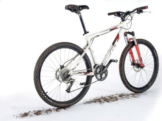

Hi, The background is that I have an old GT Avalanche 1.0 that I've had since new - probably about 2007. I'm looking to convert it to an ebike. The usage will be pretty limited as I use it on flat roads at home now and again, but take it on the back of a motorhome for country roads, off-road and cinder tracks etc.
I notice that some of the conversion costs - for example, mid drive kits with battery etc - can build up and I'm wondering if my bike is too old to use as a base. Should I swap the bike first, then add a kit? The bike itself is more than adequate for my needs, so I'd be just upgrading for the sake of it but don't want to waste money adding a kit to something thats too old. Is there a 'rule' of something like 20% bike cost and 80% kit cost? Thanks.

Thanks All. The Avalanche 1.0 was was a pretty good bike at the time - it has hydraulic disc brakes. I'd not thought about the issues with speed too much, but thanks for the heads up.
There's nothing wrong with that bike for conversion. This is an older Specialized Stumpjumper which works fine for errands, but would need a suspension fork for MTB (but not smooth dirt roads). Note the linear brakes which function adequately for me.

GT Avalanche 1,0 like this one? Looks like a nice bike to electrify. If your York location is the UK, I believe you have to watch out for law enforcement initiatives where they seize ebikes they don't like? Be careful.
