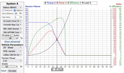

The Grin simulator has bbso2 and hd options. I use it just to figure which gear is best for a top speed hill climb. Usually the most efficient gear is on the edge of ghost pedaling, if you slow the cadence down to much the motor starts to get hotter.
Yeah that's the complex link I was referring to HS. I went back there and punched in the numbers and got this
As you can see it has Peak Efficiency at 40 km/h for running in a high gear on level ground, motor only, 70% throttle. But that's nonsensical! The wind drag at 40 is murderous on an upright mtb. How could the motor be more efficient there? When I talk of efficiency I'm talking about power drain on the battery and I know from experience the motor is hauling massive current out at that speed. Whatever that simulator is referring to it's not the information I'm seeking.
I simply want to know "basically" what motor rpm is most efficient at 25 km/h, my cruising speed, so I can pick the right gear to minimize battery drain. Or does the motor not consume more power at varying rpms, all else being equal? Is it just as efficient lugging along at 10% of max rpm as it is at 100%? I wouldn't think so.

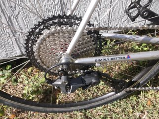

Looks like that chain is too short perhaps?
Yes, but it's good enough like that. With 36v 30A bettery, I just lock out the lower ones.
I already broke one of those cassettes by using the black ones. Exploring other options at this moment.
I put a Shimano something to 41T on the one that broke, but it's a BBS03 with an adapter so now I need spacers and long bolts to move the chainline.
