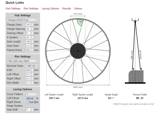

Maybe on a dyno those Shengyi's are efficient but what about when actually installed on a bike that actually makes turns and thus tests the lateral stiffness of the front wheel?
That Shengyi motor has a very poor spoke tension balance between drive side and non drive side and only 38mm distance between non drive side and non drive side spoke flange. In fact the spoke tension imbalance is so bad the best I can do is a 69:31 ratio by making the non drive side spokes "elbows out":
In contrast, a regular Shimano disc hub (Shimano Deore HB-M525A 100mm Front hub dimensions | Freespoke) would have 55.5mm between spoke flanges and a spoke tension imbalance of 57:43:
So while the Shengyi might be very energy efficient if only riding the bike in a straight line once a person needs to turn the reduced lateral stiffness will no doubt force them to bleed off more speed than a front wheel using a conventional disc brake hub.
In fact, I shudder at the idea of putting a hub like this on any bike with a more forward weight distribution. However, a downhill bike going down a hill would be in the same category though (re: going down a hill shifts more weight to the front and thus increases the size of the contact patch of the front tire. The greater the size of the contact patch the greater the traction and thus the greater the potential stress applied to front wheel during a turn. Think "Taco" when stresses get too high relative to the spoke bracing angle.)
This hub motor design needs to improve.

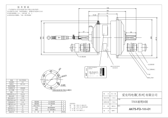

Where’d the 21:1 reduction figure derive from for the Aikema 75 motor?
The SX version uses a 21-33 nylon gear, so I can’t imagine any sensible sun and ring gears that could achieve 21:1.
A 6T sun gear doesn’t count as sensible, if that’s what it uses, but assuming it does, then 6 into 33 = 5.5:1, meaning another 4:1 reduction is required to achieve 21:1. I.e. ring gear would need to be 84T (4 x 21T). Would 84T even fit in that hub shell? They’d need to so fine pitched that they’d be prone to destruction under any kind of shock load.
I’m not saying it’s an impossible gear reduction, obviously, the numbers are plausible, but I have serious concerns about the robustness of any gearbox that implemented it in this way.

Like all other hub motors there's been basically no long term reported issues with the specifics of the wheel dish etc for any given motor.
1.) That's because there are not many people in this forum using that motor. (Example: This is all I get from a forum search of the terms Shengyi SX1 --> Search results for query: Shengyi SX1 )
2.) In the event we actually get people using the SX1 how much experience do they have comparing the SX1 as a wheel to other hubs both hub motor and analog? This assuming the rim diameter and spokes are the same. And what bike are they riding? At what speeds are they riding at? That is going to be very important for objectively determining how much cornering performance loss is actually occuring. Even better would be a controlled test though.
2.) Even Justin admits in situations where the spoke is almost vertical it has very little ability to provide triangulation strength to prevent the rim from buckling:
Now granted Justin flipped the spoke in the video from "elbows in" to "elbows out" but the resulting spoke bracing angle is still relatively vertical with 700c rim and the Shengyi SX1 non drive side bracing angle with a 700C rim is even worse than the Clyte H-UFO direct drive hub example used by Justin in the video. This because while the non drive side distance of the Clyte spoke flange is 9mm from centerline compared to 10mm non drive side distance from Centerline on the Shengyi SX1 the DD hub benefits from a larger PCD (232mm vs. 141mm) which helps spoke bracing angle. This (9mm distance to spoke flange + 232mm PCD) results in the DD hub motor having a 2.7 degree bracing angle compared to the Shengyi SX1's 2.4 degree bracing angle which comes as a result of 10mm distance from centerline to spoke flange and 141mm PCD.
Here is the "hybrid hub" (i.e non drive side Justin's DD hub motor and non drive side Shengyi SX1) I made up in freespoke to show the difference in spoke bracing angles for a 232mm PCD with a spoke flange distance of 9mm from centerline and for a 141mm PCD with 10mm spoke flange distance from centerline:
I came up with the 9mm distance from centerline for the Clyte H-UFO (used by Justin as example) because it has a 4mm dishing offset coupled to a 26mm distance between spoke flanges. 4mm offset means the non drive side distance is 9mm from centerline and the drive side distance is 17mm from centerline (i.e non drive side is 4mm shorter and drive side is 4mm longer than what would be if the hub were non dished which would be 13mm non drive side and 13mm drive distance from centerline). Likewise the shengyi SX1 with its 10mm distance from centerline is the result of having a 9mm dishing offset coupled to a 38mm distance between spoke flanges (i.e non drive side is 9mm shorter and the drive side is 9mm longer from centerline than what it would be if the wheel were not dished)
3.) Justin admits that a spoke tension balance of 70:30 results in a more likelihood of spoke breakage:
....and we are at a nearly as bad ratio of 69:31 with the Shengyi SX1 even under the best conditions (which is with non drive side elbows out)--> Hub mid-drive dual motor combos
4.) Not all front hub motors have such poor spoke bracing angles like the two examples (Clyte H-UFO and the Sjengyi SX1) given. Take for example the Aikema AKM75 you used as an example earlier in this thread:
5.3 degree bracing angle on the non drive side is way better than the 2.7 degree bracing angle for the Clyte H-UFO non drive side and the 2.4 degree bracing angle on the non drive side for the Shengyi SX1.
Also notice how the spoke tension balance on the Aikema AKM 75 is massively better than the Shengyi SX1 which has the worst spoke tension imbalance of any front hub in the ebikes.ca spoke calculator--> Online Spoke Calculator for Hubmotors and Ebikes
My prediction is that it in a controlled test you would get way better cornering performance with such a hub.
It comes from Top Bike Kit:
21:1 for the 328 RPM
14.2:1 for the 201 RPM
Something’s clearly amiss right there.
Just for fun … 328 X 21 = 6,888 RPM
Around 8000 RPM unloaded.
AFAIK, the 14.2 reduction for the 201 version is correct. 21:1 is obviously a mistake.
I agree it's a typo, but if this 21:1 reduction ratio actually exists it would be for the "lower speed, high torque, suitable for hill" application which is the 201 rpm version. Meanwhile the 14.2:1 reduction ratio would be for the "lower torque, higher speed, suitable for smooth road" application which is the 328 rpm version.
But honestly I am having a hard time believing this 21:1 gear reduction actually exists wnen Top Bike kit themselves lists both versions of the AKM-75SX using the same 33-21 planet gears:
I think I know what happened now ..
According to an email BMS battery sent me today the Cute Q75 (which is an Aikema AKM-75SX) is 12:1 for the 328 rpm version and 14:1 for the 201 rpm version.
So if Top Bike kits motors are the same as BMS battery someone at Top Bike kits got "12" reversed to "21" and thus 21:1 was inputted on the webpage listing rather than 12:1.
