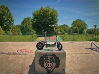

Hello friends, this is my first time posting here after years of lurking on this forum for advice. If this is not the correct place to post this I apologize. A few months ago I purchased an econic cycles 12” hub motor (8.5” actual motor size, 12.5” wheel) for my 2001 Polaris SLX707 electric scooter.
Upon first testing I did notice that it did not have the smoothest start but shrugged it off to possibly being the generic Amazon brushless controller that I only intended to use until I could afford the Kelly controller I had my eyes on. From a dead stop the scooter would lightly click and lurch forward 2 or 3 times on throttle before any actual forward momentum would happen. I remedied this by simply always giving it a kick start or running start to relieve the motor of unnecessary stress as well as save some battery and this has worked just fine for almost 7 months now.
About 2 months ago I received my Kelly controller in the mail and went through all of the rewiring and what nots I’ve done countless times on many electric bikes and scooter, however this time I could not for the life of me get the Kelly to auto-identify and it was repeatedly giving me a “hall sensor error”.
Looking more into the error code I read up on how to properly test and identify hall sensor issues, errors and failures and found that I do have a malfunctioning hall sensor. Of the blue yellow and green, when spinning the motor (wheel) by hand the yellow and green cycle on and off properly and both read proper voltage. However the blue wire sensor seemed to be reading several volts higher than what it should be and does not cycle off at all when the scooter is powered on and the wheel is moved by had.
After watching a few videos I ordered a 20 pack of A3144 hall sensors and opened the case to attempt the job. What I found however was a bunch of white silicone all over the motherboard and windings, presumably to stop vibration. I’ve located the correct hall sensor but felt that if I try to remove the silicone it may damage the traces on the motherboard. So, feeling defeated I put the motor back together and put my new controller back in the box.
Now I do still use this scooter every day with the cheap Amazon controller to get back and forth to work with no issues. I’m not sure what to do.
Sorry for the long run up but my question is this, what exactly are my options here? Are there any reputable companies that I could maybe ship the motor out to that would be able to replace the sensor (preferably for less than spending another $300), or is there an easy way to remove this silicone without damaging the board so that I could do this myself?
