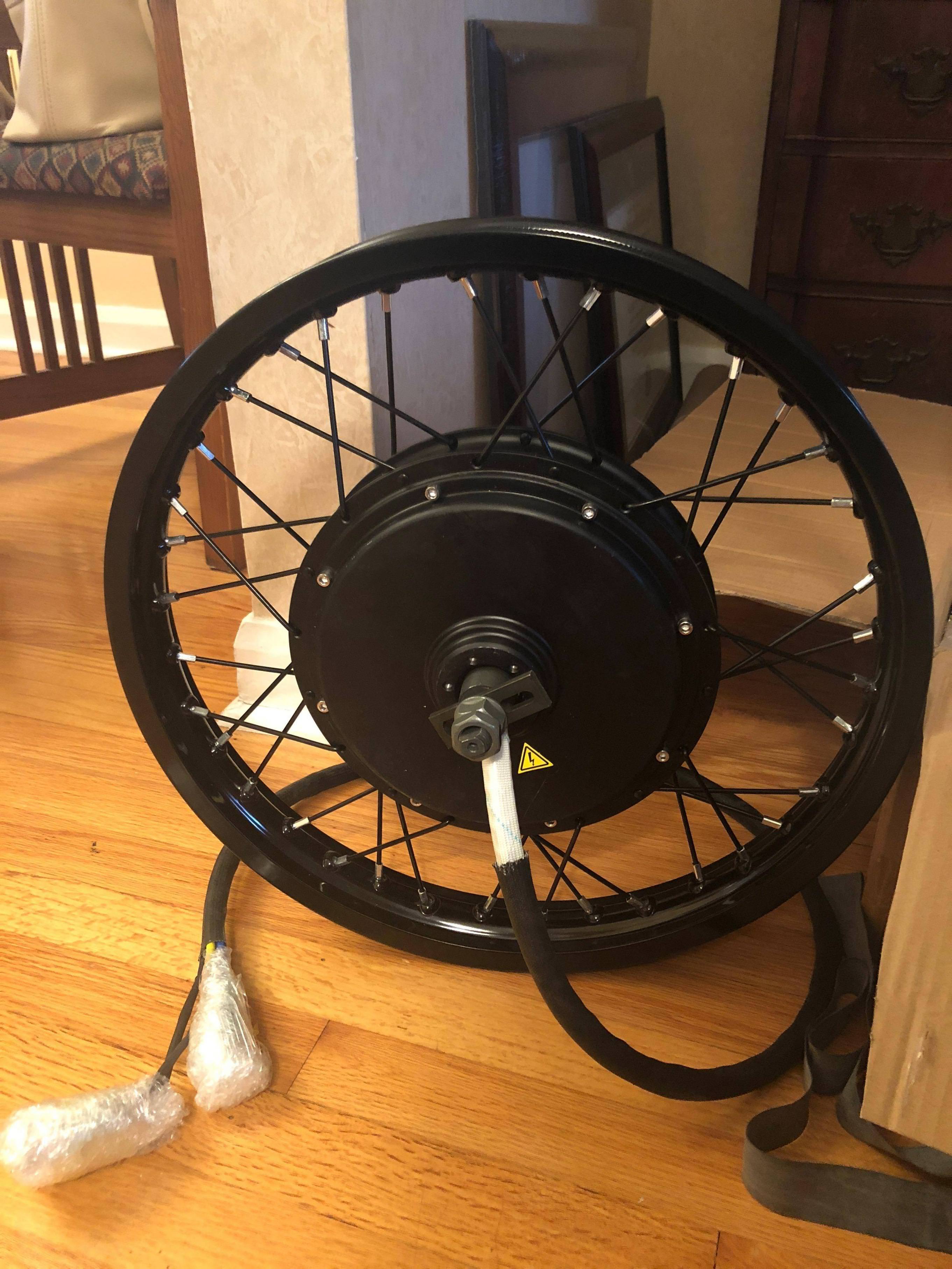

I purchased a qs205 3.5t in a 17" wheel on 10/20/18 from em3ev. I was told it shipped 10/29/18 with 3 day shipping so I'll let you know when I get mine.
