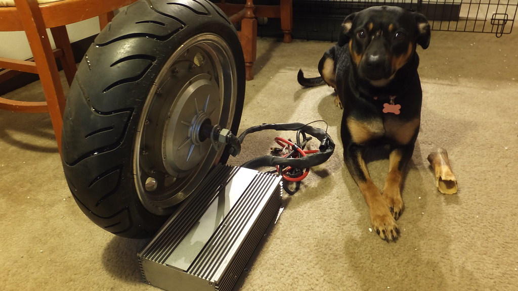

finally got my motor and controller after missing UPS the first two times! this thing is a monster! i apologize to John - that i was not able to purchase the motor directly from him. I got a deal on a used motor/controller combo from a user on ES that was too good to pass up. in the future i can definitely see myself purchasing a few more motors for friends or maybe even a new one for myself after i build and possibly sell this one.

the controller is a massive 1'x6"x3" nearly double my 24 fet greentime
DSCF0176 by mjansevreeling, on Flickr
so there you have it John. finally someone (ME!) that will be mounting a hubmonster on a lightweight bike (relatively lightweight* - im aiming for 150lb total bike weight). also i weight about 175lbs so this thing should really fly with a total weight around 300-350lbs!

At a Kv of 16-17 it's a speed wind, so I try to downplay torque expectations off the line. It's all in the gearing. eg At my voltage mine is geared for over 100mph with peak input of 27kw. Take a more common motor that can accept half that peak power that has a top speed of just over 50mph, and the perception of torque is going to be about the same. Well, up to about 25mph it will, after which Hubmonster will rapidly pull away. That's the beauty of speed winds...they just keep pulling to whatever reasonable speed you're willing to go.
Don't worry, with that light load you'll fly, and as long as that controller can deliver the motor will supply more torque than you can put to use with that wheelbase and CG height. I just don't want people to think they can do a long bike, and put their saddle up near the handlebars and do power wheelies on par with LFP's Deathbike.
The the wiring harness before connecting the controller. When not packaged to my specifications it's quite easy to damage the wiring harness as it exits the axle, and that harness looks iffy. If damaged I don't envy the task. I ended up having to go the magnet wire route to get enough copper through the axle after I mangled my harness. The primary concern is keeping the 2 sets of halls separate. The phases are different, and you can figure them out after the fact from the outside quite simply. When I redid my harness I brought the 6 phases out all the same color. For the halls I made use of the shielded 6 conductor factory hall wires. I used the extra wire in each for my temp sensore and kept the factory thermistor and wire pair. Their conductors for the halls are small, but I believe the shielding pays a dividend. I'm going to try to get them to send me a roll of the stuff the next time I have motors sent here.

although i probably don't need the speed, im sure i wont be able to help going 80+ on a clear stretch of highway :lol: im mainly just looking for a motor that can handle relatively high power and speeds for a long period of time. i don't think i have to worry much about overheating this beast (especially if i add some cooling holes/fins). i may end up using two 24fet greentimes or something like that but we'll see how it runs with the stock controller when i get my swingarm built up.
i know what you're saying about the wiring...where it comes out the axle is a bit sketchy. how do you deal with this? i removed the electrical tape that was at the end of the axle and all the wires are inside of a thick nylon? casing that doesn't have any damage to it
When I first setup this motor 2000 miles ago, I probably broke 2 of the ultrathin hall wires and left me very confused for such a stupid problem. It just happened to me twice again this week when servicing the motor. Be careful when terminating them.. make sure the joints are well anchored (especially if you are soldering). Doesn't look like you have to worry with your fancy pants "6 phase" controller.
hahah we'll see how well this controller even works. unfortunately im not sure if i will be able to use a cycle analyst with this controller? There is a connector with 4 wires marked dashboard (from the previous owner) and other than that there is only the throttle and regen connector and the power leads for the battery. all the hall/phase connectors are all wired and covered in a thick heatshrink. still haven't had time to take apart the controller...maybe on sunday
Sure your CA will work. It's just a matter of getting in there for the correct connections. Current and speed limiting functions may or may not work depending how the throttle section is done. If you pop that controller open, I'd love to see how they linked the throttle sections, assuming it's really just 2 boards in there.
