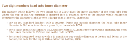

I had some movement in the front handlebars to the wheel and it seemed to be from the bearings to the front fork. A friend said he would help me so we dismantled it in my typical fashion of hammers, screwdrivers, and general mayhem assuming he knew what to do. Once it was apart, I ordered the part he recommended from Amazon and waited. When it came, it was obviously not the right part, but he said we can make it work. I think he actually meant, We can make it worse. Now he's gone, I'm on my own, and no bike shop in 60 miles will touch it. (Small town). Below are some photos I took because I have no clue what to buy or what the parts are even called. I imagine I need everything from the handlebars to where it connects to the bottom near the fork. Please help. I'm completely lost. #1 is random parts from what I bought and what I think came off.

My stem is threaded. The hole where the bearing goes is 43.8 or maybe 44mm. The bottom seems to be the same size but might be 1 mm larger. Definitely not 10mm

Looks like a 1-1/8" threaded steerer fork, though I never seen one sitting so low in the steerer hole. Perhaps there's a misplaced bearing on the bottom? Did you throw all the old parts away? All you probably had to do was tighten it up unless the bearings were shot, Then you just replace those.
Should have been an assembly diagram for the one you bought showing the order of the parts, Lust follow it to put the other old one back together.
If you have enough steer tube length to work with, which isn't clear from the photos, you'll need a 1-1/8" threaded headset with 44mm internal cups.

I don't see the photos,but if it's 1&1/8 you can procure a new headset (as cheap as $15 on Amazon) and replace the entire unit (including the cups in your frame.

You have a threaded headset with a folding steering tube on top. The latter doesn't change how it works. Threaded headsets are either 1" or 1-1/8". No other choice. Your photo says it's the bigger one. Should be 25.4, Maybe you didn't zero your caliper.
You didn't say how it doesn't fit. The threads are the same. Has to fit, It's the same steerer. What's wrong. Is the thread end sitting too low inside the frame? Did you put in too many spaces and washers? You didn't put the new crown race on the fork without remoing the old one?
The new headset also might not fit if you didn't change the cups. Chalo could educate us on that possibility, I've always changed the cups because they came with the headset.
