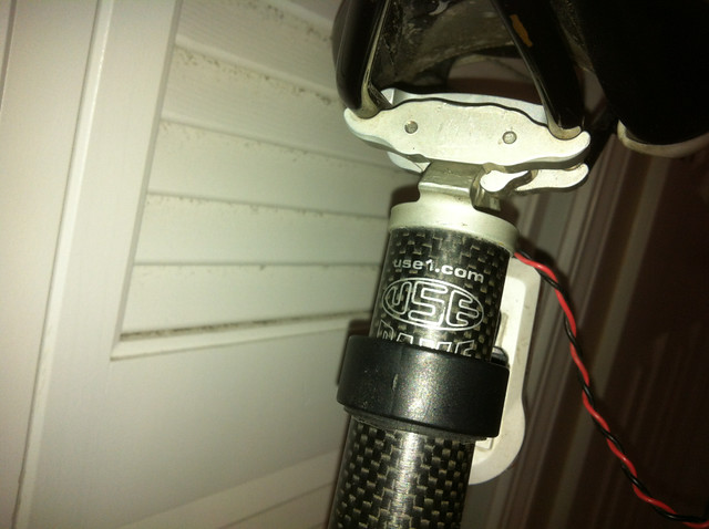

I need to make about a 2.35mm diameter hole in my seat post head, in order to route wires through for my rfid board. I'm a perfectionist about my build, and I'm trying to keep it very clean (only external wires are throttle and phase). If I have to, I can try to use magnet wire so the hole is even smaller. Key thing is that I don't want to create a huge stress point on one of the lightest seatposts made. ;)
Here are some pictures of my 150ish gram alien USE seatpost. I plan on putting it on my surly 29er hard tail for primarily road/commuting use. Here are some pics. Feel free to comment on the safety aspect of my intention on going 25-30mph on a 29er with front reba and 2.35" Big Apples and this potential carbon seat post hazard, with or without the hole.
It's probably no big deal, but I wanted the material engineers and physicists of ES to help me out...
Thanks!
Round holes are rarely problems for things, as they have no stress riser edges on them to propagate cracks.
Making slots or notches in light things is the no-no.
Yep. a small hole won't be a problem.
It is a carbon seatpost though, I would edge the hole with epoxy to prevent further fibre separation.
I used my dremel with a small abrasive point unit on it for drilling carbon tubing it seemed to werq well and did not need any dressing up when I was done. You might be able to drill down through the aluminum top of the seatpost as well. The angle would not really matter. What's the wire for external power? I have been trying to figure out how to turn one of those into a brake light as well as keep the flashing stock. But things are tight inside for a solder iron.
It's for powering the rfid board, as well as for serial output and enable lines. The idea is that I will unlock the bike by sitting on the bike, and it will effectively scan for my ass. I will go straight down about 3-4 mm from the edge of diameter of the flat part of the aluminum. I hope that it isn't very thick.

Perhaps drill it very close to the top if your worried? so it goes through the aluminum that is seated
in the top part of the tube? small hole though wont make a beez dick of a difference to strength..

uh oh. I started drilling it closer to the edge.. stopped when I realized I was too close. only 1/8" of aluminum. Moved inward.. only 1/8" of aluminum again. Keep drilling... carbon keeps coming out for over 1.25" depth of cut. Tested it by actually measuring through the other end and there is indeed a whole bunch of somerthing in the middle for about 1.25". if aluminum goes down farther it must be right dead on in the middle.. and probably around .5" in diameter.
I led the hole towards the outside of the post cause I miss judged the actual width of the carbon tube (cause the aluminum head is 29.3mm in diamater compared to 27.2mm)---- so I think I ruined it. I imagine the very tip of the bit is about 1/8" away from perimeter of tube...
FROCK!!such an IDIOT!
Maybe I'll have to inject some jb weld in there to fill it up and then start over from a more centered point. Good plan? Safe? encouragement?
Forget the seat mount, the end of the carbon fiber tube is fragile and more likely to start fibre separation.
I would drill in the carbon tube, in the rear. then cover the edge of the hole with epoxy, maybe an eyelet...
Just fill what you've done with epoxy
I would have drilled in the middle of the aluminum as you said. Might even have to drill deeper than 1.5 inches hard to say for sure. If you can get some epoxy down there it would be good but might prove difficult without some kind of syringe and a more liquid type of epoxy. Good luck
My first thought it to drill thorough the center of the side of the brake light bracket. The bracket clamp will be transferring any stress at the hole, above and below the edges of the bracket.
You can get some of the epoxy that comes in a syringe and just inject it in there, and drill your new hole as close to the center of the aluminum cap going down, or like DS said, just through the top of the middle of that trigger shaped portion and feed the wire through where it first exits the cap and you should be fine. :)
This sounds very reassuring. The middle of the big top part is very thin.. I'm not sure how integral it is for support. Its a mm thick. I can still go at this closer than in the picture.. Just need long enough bit. Would 6mm from center be acceptable? I feel like this thing has been engineered for minimal weight and probably needs that thinner middle section. They definitely had a good opportunity to Cnc mill all the way through
It's about 3 inches for a good read. I'll have play around with it for sure. There may a closer moment when the bike is just being mounted... Which is all that is necessary for enabling the bike
There are some other boards with a little more distance but I paid $10 for this guy. The engineers are already prototyping much larger distances, but for this application 3-6 is just fine
I put in some 6 minute epoxy. I kinda just dripped each part it in separate (alternating drips) and then agitated it a bit to get out the air bubbles. I drilled a proper hole down the middle and it was only about 3/16" thick aluminum and no carbon. The carbon must be a little bit beefed up towards the sides on the top.. maybe by about 30% tube wall thickness.
I looked over my post and the drill bit had caused a small bulge. Hopefully there is still enough material left to support me. Worst comes to worst, the seat post breaks and I have to stand up. I suppose I'll be more cautious when hitting curbs or other bumps.
