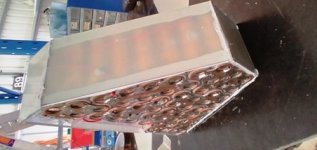

All's well with this battery except one of the 24s23p modules had a bank of cells bombing out in winter. I steeled myself to build another module, so that come summer I could do the replacement. Last summer (21-22) was a doozy in Perth - hottest on record. So I took the car for a long drive to get a baseline on range. Bloody thing clocked up 130 km of mostly highway driving! No cells bombing out - what gives?
Then I realised. Thermal expansion coefficient of set epoxy resin is pretty significant. I had built the battery in summer, so come winter, the epoxy shrunk somewhat. Thanks to the often lousy contact the nickel tabs made with the nickel-plated aluminium, during the cooler months, they made poor contact and the effective capacity dropped. When it warmed up again, contact was made, and the capacity returned!
So the replacement module was made using copper busbars with soldered nickel tabs. These stuck substantially better than the spotwelded ones, and were actually faster to prepare...
