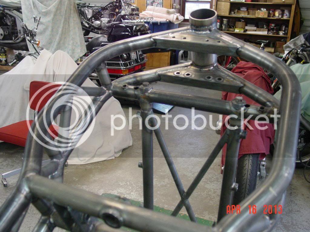

Randy promised me some pictures of the battery frame cradle but I've not seen them yet. Maybe tonight.
I had a very pleasant surprise in my inbox this morning!
Randy has finished the battery cradle and it simply bolts in place between the headstem and the motor cradle.
It looks like it hangs down a long way, but the base of the cradle should be about 130 mm off the tarmac.
Lots of options for attaching the fairings as well as the radiator up top.
Nice and rigid. Looks like a bit of a fatty, but it's no wider than a Kawasaki 636.

That is SO SICK!!! can't wait to see it go! Frame looks like a tank, chromo trellis frames ftw.
Wow that thing is built like a tank
well at least it will be crash proof. :p

An important trait when pushing stuff to the limit ;) More crash proof than a dual Indian smoke machine anyway. Remember, it's holding 9 kWh of LiPo, 150 kW worth of motor and hopefully tipping in at 200 kg. So strength is a good thing.
