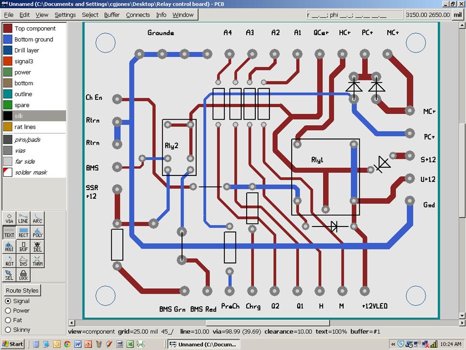

Minor update on Voltron Evo's progress for the upcoming Round 3 of the eFXC. I have the relay control board managing the contactors inside the battery, doing things like opening the half contactor while the two quarter contactors are closed. Now that I have the Rinehart managing precharge and the main contactor, I could do away with the delay timer. But the BMS relies on a small reed relay which is powered by the NC loop of the BMS output, and this currently sits in the top of the battery pack. If I could consolidate this switching equipment, as well as the outputs for LEDs, it would be much neater. So I finally decided to learn how to make PCBs.
gEDA PCB is a pretty simple program, and it's free. Unfortunately you still have to go through the text file and make edits as standard practice, as the program doesn't allow you to chance certain things like hole diameters and clearing soldermask. Still, this wasn't a bad effort I think :)
It's slightly different to this screenshot, as there are suppression diodes on both relays as well as a new resistor for the 'BMS sad' LED. A buzzer will be fitted to this output too. The board also allows me to have an LED lit when the precharge relay is energised. Only a couple of minor problems, like the 3 A diode legs not fitting through the 1.1 mm diameter holes, but they can be surmounted.
I have just populated my first board, but can't really test it until I have a few more things made up, but it should make for a very neat package :D
Yeah I have tried to design some 2P boards for the 40C cells, but there seems to be a problem with the soldermask function. I could probably do it, but there is no way of removing the soldermask from the layout. It's good for removing soldermask from holes or vias, but not whole pads for some reason. Still learning...
