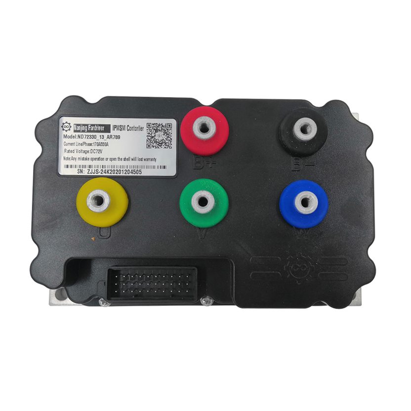

Motor Controller -
1) Sine Wave.
2) min 200A support. For longer life into other future projects.
3) Easy learning curve with speed limiting (45mph, but might stretch it out once or twice for YouTube likes, ha. it's still a piggy fat tire though).
Something like the ND72200 FarDriver Controller with Bluetooth, 72V, 200A Battery, 200A Phase

I think the first far driver I put up above would limit me on line Amps. The battery can do 120A/175A peak.
While I won't live at that max line, I do want to get a controller that can grow to do more later and live longer.
360 Amps phase, 170 Amps line
That controller plus a dkd display and a throttle should be all I need. I am waiting on some quotes. Hoping to hear more from you all on the sanity check.
