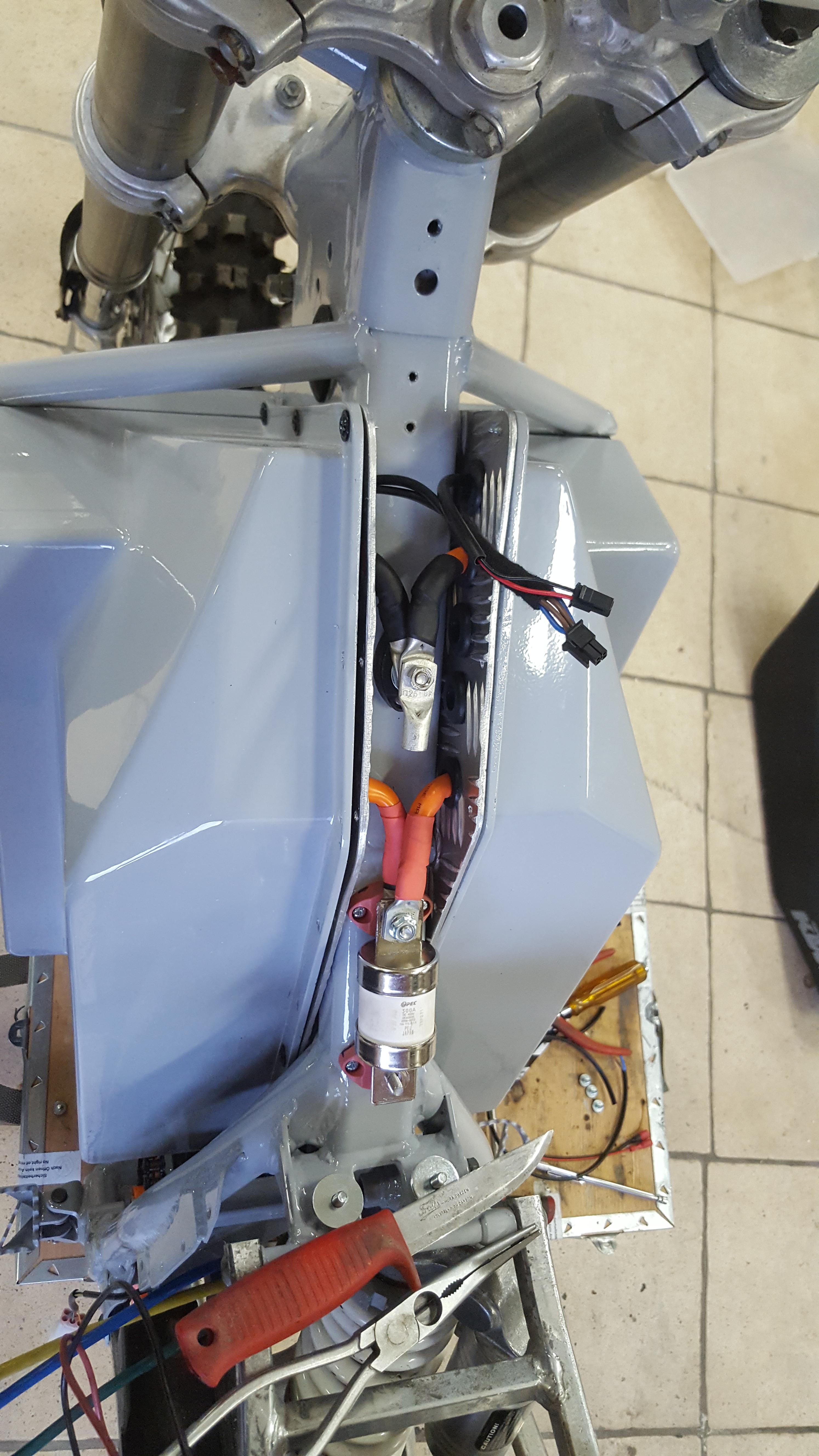

But first things first, a little extra protection over the hv stuff:
Mounted everything, I "borrowed" the nucular 24fet from my EEB "stealth bomber" and turned on the ignition. I could hear relays switching, and then nothing.
The controller wont turn on. Measured voltage, nothing.
Unplugged solenoids, they sure turn on and off. Measured before the fuse, voltage.
My "little" fuse was blown
I had another one, switched and things worked. Did an auto setup, and the motor only turned in one direction.

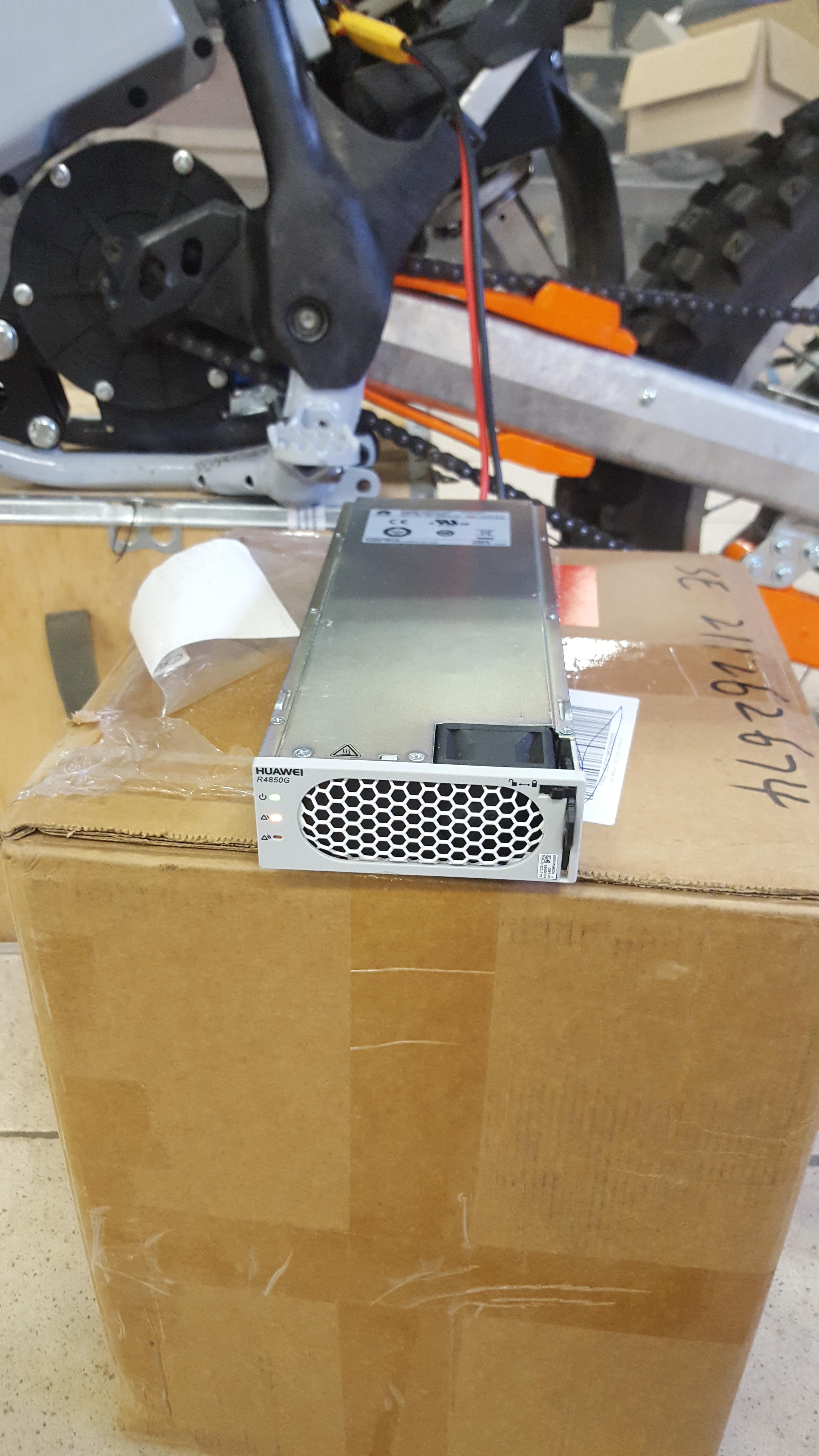

I have 2 of these huawei R4850G2 psu:s , that I planned to series connect and adjust to charge to 88-90v.
They are adjustable trough can bus, and I have ordered control boards with potentiometers to be able to set both voltage and amperage. But where they are seems unknown :?
I did get a picture of them anyway, I guess that is something.
