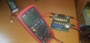

tatus1969 said:
frnandu said:
Is this "REMOVE SHORT" error cause only possible if this diode is somehow damaged (even if it looks ok)?
If so, can it be easily replaced with an ordinary soldering iron?
I need to order from you new electrodes, so if indeed I should replace this diode for stopping the error, maybe you can send me a replacement together with the electrodes?
It is not always easily noticable when these components crack, sometimes the black top only lifts up very slighlty above the large metal tab at the one end. There are other possible reasons for this message, but I now realize that I haven't read your initial post correctly. You say that you had removed and connected the fuse and that it then worked. I somehow had read that you had removed the TVS diode, which is why I gave that warning. This is a completely different situation, and I am thinking about this right now as I haven't had this before... A few questions:
- you actually removed and replaced the fuse while the system was powered from the battery, right?
- are you sure that you have never accidentally touched something on the logic board with one of the electrodes?
- are you sure that you haven't applied external voltage to the electrodes?
- can you once measure the voltage across the electrodes, a) hafter having powering the system, and b) after you have removed+replaced the fuse?
Hi Frank,
For a few weeks the "Remove short" problem somehow went away (didn't do anything, just several times disconnected and connected the battery and it just stopped appearing), but now it again shows up (simply by reconnecting the battery), so I did measure the voltage across the electrodes as you asked.
The voltage is 8.37v (when it shows the "remove short"), and after I disconnect the fuse and reconnect it (the error goes away) it is 8.19v.
Here's a short video showing the error and voltage:
https://photos.app.goo.gl/TQ9F8TB8yWynGr4j6
and pic after reconnected the fuse:
Can you figure out what might be wrong?
Let me just add that this is something that since the very begining we (me and another guy you bought the kweld together) have been having, check the very first time in January we posted here about this problem:
https://endless-sphere.com/forums/viewtopic.php?f=14&t=89039&start=525#p1440919
So, even before we started using the kweld this error was already appearing. But then it went away and we didn't tough anymore about it.
It might be that we somehow made an error while assembly, but we can't figure out what exactly. We tried to follow the assembly manual carefully.
The voltage is absolutely okay, and if the welder makes consistent welds as well then I suspect an entirely different problem. Do you have the firmware updater so that I can send you two different firmware images for testing? I'm varying the 'short' detection parameter so that one firmware should always fail, and the other should always pass. If my theory proves true, then there will be an easy fix for this.
