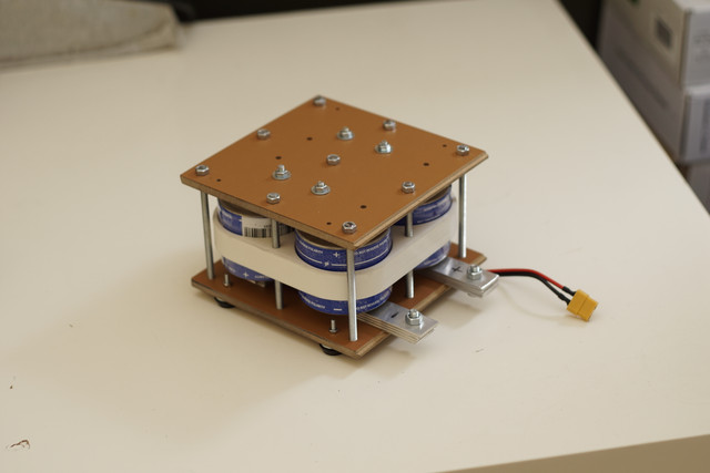

I bought a kWeld last year with 4 of those big super caps which Frank was selling separately. I got around 1150A which for steel is enough but i have problems with 0.2 nickel and most of the time only one spot of the two is sticking. I make 3 pairs of spots weld but i am using it for commercial application and i can't afford to have half of the spots not cooked properly.
I can rip one of the spots easily and i'm relying on the other one that "hopefully" it will stick(50J pulse). I often stack 4 layers of 0.2 nickel(one after the another) and i have to be absolutely sure that is sticking. I changed the battery cables to 6 awg which gave me a total of 1300A, i tried cleaning and maintaing a perfect shape of the tips , putting enough pressure but nothing seems to help.
I am thinking that 0.2 nickel just needs more current to cook properly, i would go to the max 2000A or even higher by shortening the probe cables and rotating the spot welder 90degree for shorter reach. It would be also nice to change the probe cables to at least 6awg, but i dont know how to change them and still use the original probe holders.
If i knew from the beggining i would have bought 8 supercaps for 4s2p configuration. I dont know if Frank still has some of those caps. Another power supply ideea would be a 4s battery built with A123 lifepo4. Those can give like 120A for 10sec, i suppose 8 of those in parralel can give 2000A in a short.
I would be glad to hear some of the forum members about their experience with kWeld and what power supply they use for properly cooked welds and also opinion.

Received my kSupply and kCap a few days ago and I am amazed how well they work: Super fast charging (using a power supply for a Dell server with very close specs to the HP HSTNS-PR01) and nearly silent.
These are superb products :D Thank you, Frank!
I do have a question regarding the voltage listed in the manual of 8.1v.
Turns out the SkelCaps capacitors used, pack quite a punch and if I set the voltage to 8.1, cannot calibrate the welder because it reports "overcurrent", probably because I mounted the welder right next to the kCap and there is minimal current loss there.
I found two ways to fix this: by replacing the AWG 4 cables from the welder to the welding head with thinner ones, OR by lowering the voltage on the kSupply to 7.1 volts.
At this voltage the calibration reports just a few amps short of 2000. Consistently :D
Is it OK to run my setup at 7.1 volts?
No warning LEDs come on and I am getting wonderful welds even using 0.2mm pure nickel strips, which I was not able to do well before I got the kCap.
Not sure if there is any negative long term effect by running it 1 volt lower.
On my kCap with the SkelCaps I need tu use more than 8,1V, otherwise the indication LED's on the PCB of the kCap would indicate that it is not fully charged. I increased the input voltage to around 9-10V and that is fine.
As written a few posts before, it looks like that the new SkelCaps can handle a higher voltage and so the cut-off-voltage of the input was now also increased. Unfortuantely this information is not listed anywhere and on the homepage of Keenlab there are still the old caps listed and also in the manual.
The measured current on the kWeld I get from the kCap is around 1650A with the original cables used for the connection between kCap and kWeld.

4 of the capacitors on my kcap blew up on connection. Everything wired up as described in the manual. Positive and negative correct.
Hooked caps up to a 15v 40ah lab supply from powertech. Set volts to 8.2v and aps to max (40). Hooked up leads then turned on power supply. Light for overtemp was on and kcap had a lot of heat coming off it. Also 2 balance lights on. Two steady lights for topping up were on also.
After about a minute one cap blew up, shortly followed by 3 more.
No idea why this happened other than potentially the kcap being faulty, or maybe affecting the board with static electricity during assembly. (I did ground myself repeatedly) [
