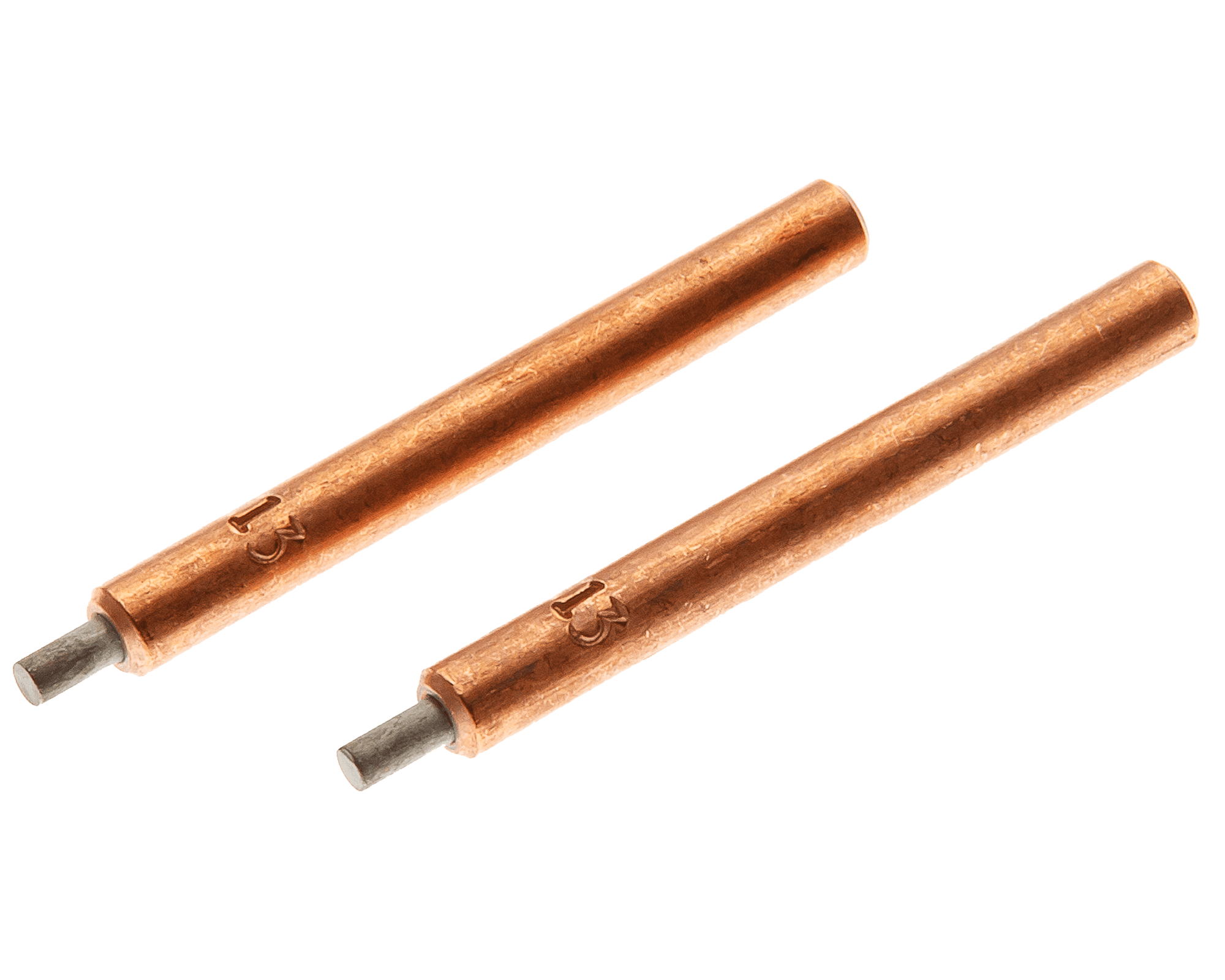

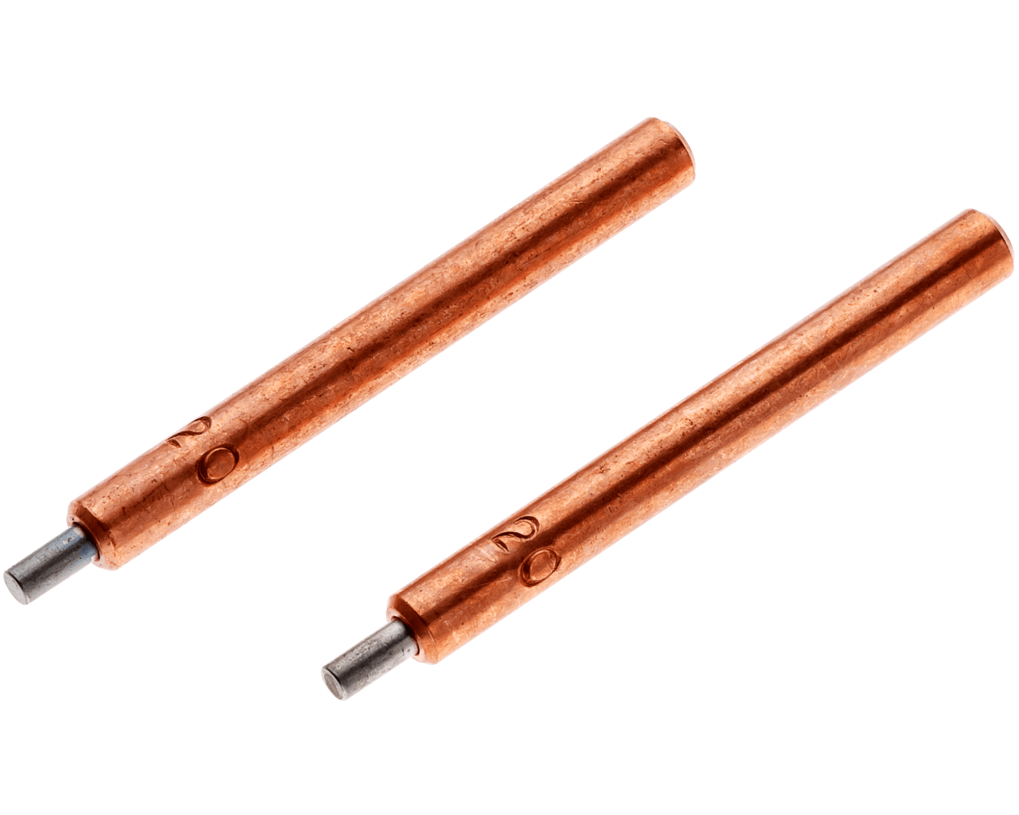

RWMA Materials - Descriptions and Common Applications
I found interesting the following classes: 13, 14 and 21 though the most interesting seems class 13 because:
-tungsten is very heat resistant and maintains it s strength at very high temperatures
-it does not alloy with nonferrous materials.
I would like to try some tungsten electrodes but not sure if it’s going to be the best choice.
The tungsten, and some of it's alloys, have the problem that they can only be sharpened by grinding on a diamond wheel. You can google TIG electrode sharpening methods. Although, you must take into account, that for TIG welding they need to be sharpened to a different shape - much sharper and small point at the tip, which is somewhat easier to be made. For spot welding a blunt point is needed. And it's much more complicated to be made consistently if a flat wheel is used.
Then, due to it's higher resistance, it will heat up the holder quite fast, if a solid piece of tungsten is used. That's why commercial Tungsten (and Molybdenum) electrodes sometimes have only a thin cylinder of tungsten pressed in the middle of a larger cylinder of some sort of a copper alloy. But using a solid piece of Tungsten is still possible.
There is this for Tungsten and Molybdenum:
Guidebook on Resistance Welding Electrodes for Tungsten and Molybdenum Based Electrodes
I'm giving a link, since it's hard to get it if using google or other search engines only.
For some reason it can not be found directly, even if it is there, openly and for all.
It's interesting, that they explain electrodes for welding of Aluminum too. If I remember correctly, somebody here asked for that. There are some cells with Aluminum tops, like for example Samsung 33J.
