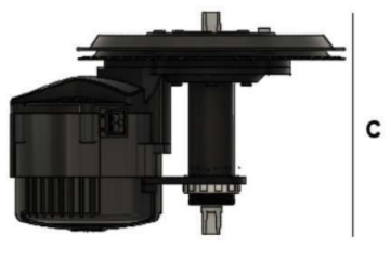

Currently shipping the 250w version for the Indian market to comply with local road rules in India and Australia. However, We are also preparing to launch our 1000w version for off-roading and USA soon. Attached is our technical spec sheet of 250w.
  • Technical Specification Sheet.pdf
Okay, here's my thoughts.
4.2kg for a 250w rated motor is bad, compared to a Bafang BBS01 (350w & 3.2kg)
What is the realistic power rating of this motor? it looks big, i would imagine it is much higher.
If this 250w unit is hiding some extra power then the weight can be justified.
Added pedal offset looks worse than most mid drives in this category
Most mid drives now have a torque sensor instead of PAS. This provides a more natural pedaling experience. People are starting to expect this.
I don't find this product appealing. I think you should aim for a product better than a bbs01.
There may be more interest here in the 1000w drive!
the motor can output 500w, still we are overweight in that category.
Thank you for your thoughts, we will improve in our next generation gearbox. We have already considered some features like torque sensor, better overall design, shaving off more weight to make it lighter.
Pedal offset is now a great addition(thanks!) in our improvement backlogs.

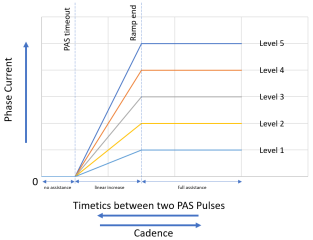

Have the PAS sensor actually control the system via the cadence of the rider.
There was the "PAS v5" in the very early days of the Ebikes, that had an analogue output, so you can feed the throttle input with it directly. My very first conversion kit in 2008 worked that way. The VESC PAS integration has a similar option. But I didn't like it, I prefer a system with torquesensor.
There's a number of DIY methods to do it.
However, what I am pointing out to them is that they could do this with what is already in their system, if they have a standard cadence sensor, and improve the controllability of their system this way.
Having this type of direct control via the pedals doesn't require a torque sensor, though that can certainly make a system more finely controllable in several different types of situations where simple cadence control isn't quite enough--it's still far better to have the cadence control than it is to just have the present common on/off pedal control at whatever assist level is chosen.
There's plenty of people, including some that have posted here on the forum, that have trouble being able to ride systems like this, for various reasons, some of them involving safety.
Having actual cadence control, with just a regular cadence PAS sensor, is enough to help most of those people...but they shouldn't have to learn everything about how to DIY their stuff just to get this, like I have. ;) They should be able to get bikes or at least kits that are easy to install and just go and ride, with this type of control.
I don't know why the industry in general seems so set against it. :(
No, I don't think so. It's inconvenient to get full power only at high cadence. That's my personal experience. A normal cadence dependent ramp is implemented in the Kuntengs already.
