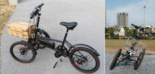

A customer asked if he could put a Bafang mid drive motor on my new frame, I searched the dimension diagram, perhaps this could do
rear box simple mounting on trailing arm

I'd received the Bafang mid drive motor,no need to explain,you know what to do

BF mid drive express
nicobie said:
Looks like it'd be fun to ride. Is it at all tippy?
I can't get English slang
Dirt road test
It is a leaning trike. Unless it were to lean beyond the limits of the mechanism, it "can't" tip over. ;)
He meant "does it tend to tip over" or lift the wheel that's on the outside of a turn.
