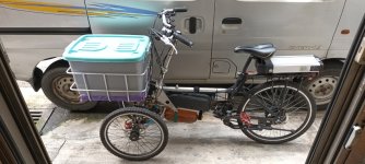

5L bottle water has more clearance with crank than 6L, better for XC riding, and I suppose it's easier to get 5L bottle water worldwide

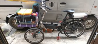

Front box is just right the size the store nearby can deliver through website shopping which I bought the folding chair and the table

Coroplast lining floor & walls inside the wire basket for grocery shopping
