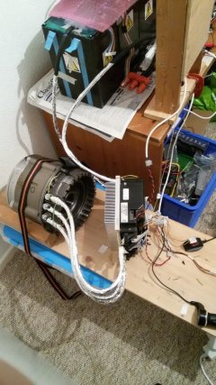

If that is true, then even bigger reason to doubt it being the 5v rail.
Biggest pointer to that is, at 100v it works fine even at 20 and 30 amps for the FOC test current, it does not generate and overflow error and then runs the motor just fine.
Once I get some aluminium tape I will start on my EMC shielding.
Thank you very much guys for the advice, I will just keep plugging away at it.
Not really, because currently for me If I go up in pwm duty cycle i get an higher voltage on the output, plus I checked it with a scope when went through it. But if you have some nice scope traces to prove it no problem.
Quick way to check, 5 volt on the pin, what does the phase output do. :roll:

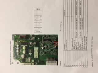

Maybe it is worthwhile you guys try out de 'buffered' approach I use on my own PCB. you may already have this, maybe not.
Basically what it does is from the high voltage it has a DCDC to 15V, and then from 15V it has a second DCDC going to 5V .
This makes that the 5V hardly sees any spikes from the high voltage, as the 15V is kind of an extra buffer in-between.
In my case the 15V is the gate drive supply...
You could also try using two separate LiPo batteries as low voltage supplies, like a 4S with a linear regulator for 15V and 2S with a linear regulator for 5V. This way you can determine if the noise/voltage drop is actually from the main supply or some inductive noise.
When I did my initial tests a long time ago, I used batteries for the 15V and 5V supplies, mostly because I didn't have isolated supplies at the time, but it can come in handy while doing extensive testing too.

Maybe ask Arlo1 for tips about how he has set up the 5V supply, he's succesfully running over 140kW with a 470V battery...
I can help.
You need booth the 5v brain supply to be isolated as well as the 0-5v battery voltage measurement setup. Which is Using a Acpl-C87 and a op amp 4.7v = 470 volt at the battery.

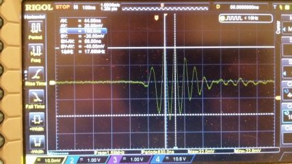

It is definitely noise
This is just scope ground and floating probe. So there is quite some noise.
What my setup looks like now. Only difference is that I made an aluminium tape covered enclosure out of cardboard that I am grounding, next to try is a 5v dc/dc on the board.

Done more testing, measuring the current sensors during the FOC measurement and looking at the traces there are no wierd anomalies. Also looked at a few of the phase drive signals also look fine, except the small emc ripple.
Going to try a few more setups to minimize the emc noise. Has anyone beside Arlo built a Lebowski powered HV (100+ volts) setup? Arlo has the big benefit of having tiny phase leads and nice grounding case.
I think somehow it has to do with how the measurement ends. The chip does the measurement and then shuts down PWM, all FETs off. Current still flowing in the motor will take the path of the diodes and be dumped in the battery. Resulting spikes etc can affect the 5V and reset the controller IC if the system somehow is not build robust enough.
More current would mean bigger dump in battery, so it would be interesting to try the measurement with lower current.
Also, I could ramp down nicely after the measurement and prevent the big dump. BUT I also see this as a kind of litmus test, basically if the system fails the FOC measurement it doesn't deserve to live, I.e. it is likely it will have problems during normal use...
