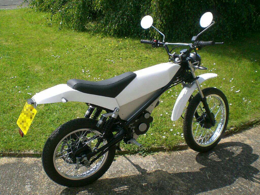

A guy called Sparta has just done this last week, see his thread "Honda MT50 road legal conversion" here is his bike
Thanks, will definitely look into that!

Welcome to the forum. Sounds like a fun project.
That Honda MT50 is awesome. the original bike has a very similar design to an MB5 that someone here converted with a massive rear hub motor. there's a thread about it here, too. Great bikes, but much bigger and heavier built than a moped. I've got an MB5, and keep dreaming about converting it.
