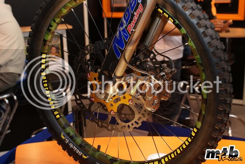

Brakes for cromotor 24s4p on phasor frame 24" wheel.
Need some stopping power to feel safe!!!! My top speed should be around 50mph.
I don't mind spending a few extra bucks to get good results. Though by all means if someone has a good cheap adequate solution please tell me.
Here are the brakes I'm leaning towards buying.
Avid code R, avid code is close to another $200
http://www.ebay.com/itm/NEW-2012-AV...Cycling_Parts_Accessories&hash=item2a1466f8d6
Or
Gatorbrake 8, I can get these for $429
http://www.ebay.com/itm/Gatorbrake-...Cycling_Parts_Accessories&hash=item565122685f
Any information would be much appreciated!

Both above brakes are hydraulic. Gatorbrakes is pretty close to motorbike territory

Avid BB7 with a 9 inch disk will be more brake than you will ever need for that bike.
If you really like Hydros, get the Avids, but there isn't any real point. Breaking power is a function of the tire. Any brake that can lock the wheel can give maximum power.
After try and comparing a lot of brakes, I went with Mecha Avid BB7s over any drippy brakes for my 50mph+ 120lbs Monster bike.

Something a bit odd. Surly Larrys. 4" wide tire on 65mm wide rims running at 25lbs, so I have a lot of tread in contact with the road.
Thats not a recomendation for those tires at that speed. They get hot. But it takes a stout brake to skid that much tire in contact with the ground, and my BB7s do it fine. Then again, a quality hydro would do it fine too, but hydros don't add anything extra.
A lot of this is about feel. Some people like the super light feeling of drippy brakes. 1 finger stops instead of 2 finger stops, and fluid smooth feeling of the lever. Personaly I find the slight lag when releasing the brake as anoying as fingernails on a chalkboard, and I want the brake stiff enough that I can feel it's bite point through thick gloves.
BB7 also have pads available at almost every bike shop. Even walmart carries them.
