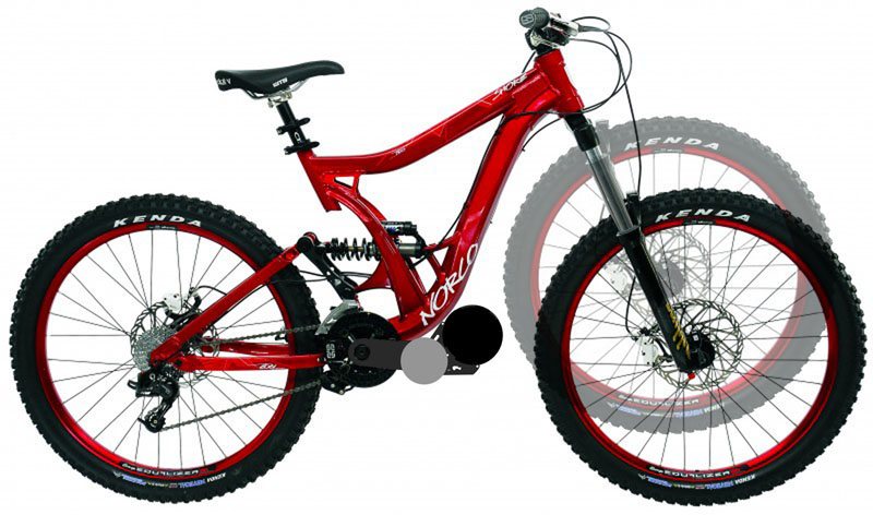

Hi all
I'm planing to mount a small block on a norco shore 2. Do you guys think it will fit the odd frame? I'm affraid it could hit the front tire when the fork compresses.

Exactly that will happen, or actually the standard kit will hang so low, that it will hit every log or Rock you'll roll over.
So that frame is really not ideal for those Kind of Mid drives.
You could ask Mike if we will make a custom mount for you, still it will not be fine on that kind of Frame.

I found this picture, the frame is similiar even though mine is a bit more "bent".
Anyways judging from the clearance of the bike in the picture, there might be just enough space to fit the motor inbetween the frame and tire.
That's a good example. When there are tire clearance issues it's usually between the large primary pulley on top and tire. You can fit a smaller diameter 219 sprocket on the primary if you don't mind a bit more noise than the belt drive.

As luck would have it I've been playing with that photo you posted.
Because of the big dogleg in the Norco's front downtube and the amount of travel in the front suspension it appears that the front wheel would hit the current drive layout. Even with the small sprocket. So let's try something else.
This is something that I've been wanting to do for some time on these "dogleg" frames. The motor is pushed so far out that there ends up being room for the reduction shaft in between the motor and chainwheel. It's actually kind of brilliant. Having everything more or less in a straight line makes the entire structure much stronger. Plus we won't have as long a chain run as with the old way of doing things.
The only problem is that this doesn't exist yet. So I guess I'd better get to work. :D

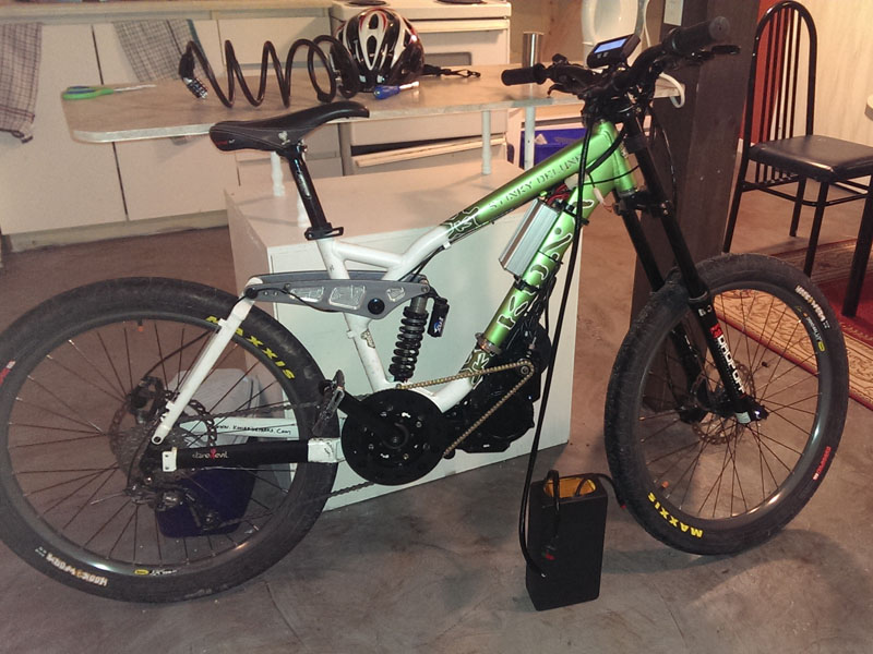

The new downhill drive is making great progress. I decided to completely redesign the mounting brackets. The right side bracket will be a one piece cut from .190" aluminum. The left side will be two piece to make the bottom bracket mount adjustable for different BB widths.
Here it is on the Norco again.
Here it is on a Specialized Stump Jumper.
I tried mocking this layout up on a more traditional frame with a straight front downtube. The standard drive with the motor below the jackshaft works better on those frames. So this will be a new drive specifically for downhill bikes with the "dogleg" bend in the front downtube. I have some other tricks planned for the drive enclosures, but I'll make more progress before I start talking about it.
