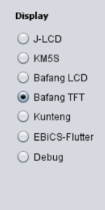

After finishing the project I would like to give something back to the project with the manual I am currently writing and the improvements in the Java Configurator.
I hope that this will save other beginners a lot of frustration.

I have had a look on it and see that the problem with the directory name come from the point, that in the JavaConfigurator-directory there the subdirectory is called "inc" and in the main Path it called "Inc".
Do have a clear sollution on of both directorry names should be changed (after the change in the java configurator maybe JavaConfigurator/inc to JavaConfigurator/Inc
