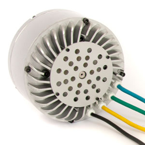

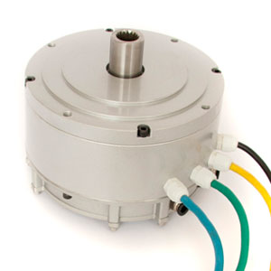

Hi, I found this today, wasn't there last time i went to golden motor's website :
Could be an upgrade from your current motor maybe ?
air cooled 288$:
Liquid cooled 308$:
Specs:
Model: HPM3000B -- High Power BLDC Motor
Voltage:48V/72V/96V
1. Voltages: 48/72/96Vdc
2. Rated power: 2-3KW
3. Peak power: 6KW
4. Speed: 3000-5000rpm
5. Rated torque: 10 Nm
6. Peak torque: 25 Nm
7. Efficiency: >90%
8. Dimensions: 18cm dia. 12.5cm height
9. Weight: 8kgs
10. Cooling: air or liquid cooling
Data sheet http://www.goldenmotor.com/hubmotors/hubmotor-imgs/HPM3000-48V3KW Data.pdf
