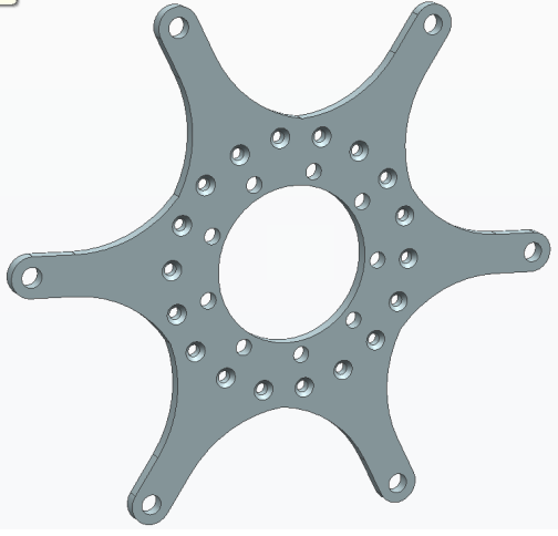

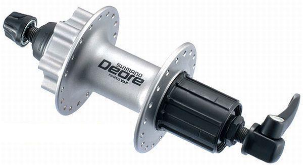

9 inner holes for M4 bolts to the hub (into the right side spokes flange of the hub), 18 outer holes for the spokes. six holes at 5.25" BCD for the #219 sprocket
interesting... that arrangement would put about half the torque directly into the spokes (and into the rim). the other half through the other flange.
seems like it would work. has anyone tried this before?
this hub has tall flanges. how about mounting the sprocket adapter onto the flange using those 18 holes? and drill a few more into the flange for good measure. then just use shorter spokes for that side
revolt and big block both have cheap .5mm lams. why pay a lot for a motor with cheap lams? there is no alternative motor of that size+power that has halls mounted and is controller friendly. If the revolt had thinner lams.. still no answer if the Pro Version has?
This hub flange thing was just an idea, i never tried. Most cheap method i can see. I would use a hub with 12mm shaft, not the squashy 9mm quick release type
