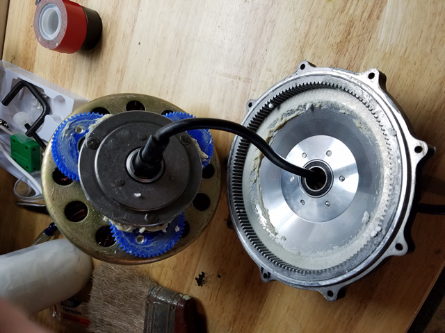

As a MAC not GMAC, it has the clutch & gears. At 5000 miles the gears & clutch were inspected with well over 50% life remaining.
It's just an incredibly well designed motor. While I prefer the freewheeling component for the human only experience, the GMAC is a better layout for mounting and connecting.
