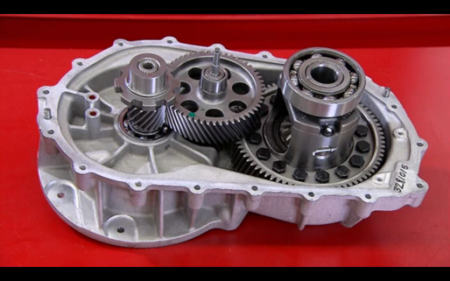

Doesn't Tesla already have a large reduction between the motor and the diff to allow the motor to spin faster and increase the power density?
yep, telsa does not use hub motors, they use single-speed reduction inrunner bldc drives. that's my favorite. The motor spins at up to 14000rpm https://my.teslamotors.com/roadster/technology/motor
Gear reduction must be in the range of ~8. As an engineer, i'm sure it's a two stage reduction drive like the Nissan Leaf drive, but ATM i can't find an exact reference
Power density can be increased almost 1000% compared to a common DD-hubmotor this way, while maintaining superior efficiency over the drive cycle. Tesla claims outstanding 88% over the drive cycle. Maybe one reason Mercedes Benz simply buys those units instead of making their own. Also read about the Astro Matt Schumacher belt drives for reference https://www.electricbike.com/astro/

why not make the motor spin 10x even smaller and spin it faster and just use a further reduction?
A gearbox remains a device which converts shaft power and the energy stored in your battery into waste heat and friction as it chafes itself to eventual failure.
What is done today in the infancy EV's will be looked back upon by folks wondering WTF we were thinking.
If one finds themselves with an application where they want X amount of torque over a speed range (say 0-1,000rpm), it's possible to solve this many ways. We could start with something spinning at 100,000rpm and make an adequate gearbox. The end result would be starting with electricity, and converting it into high speed low torque shaft power output from a motor (which isn't what we wanted to end up with). Then we could take this input and devise a Rube Goldberg-esque series of levers to trade shaft speed for leverage, and in doing so add a number of series losses and added mechanical complexity and failure modes.
Alternatively, it's also possible to simply make the conversion from electricity to output shaft power using motor geometry that works over the speed range and torque desired, and add no further stages of loss or complexity.
I think if we look at RC as a predecessor, we already know where EV's are going. When brushless motors hit the RC plane world early, they were stupendously high RPM motors that all used a gear reduction to spin a prop. This worked acceptably, and RC planes flew well and when they crashed or got enough hours on them people replaced the gearboxes etc. Nobody was complaining at the time, as nobody knew of an alternative that was better. Today go to the RC flying park, every plane has a prop bolted to the rotor of a direct drive outrunner. Nobody uses a gearbox anymore, because motors became available with geometry that natively works (pancake outrunners) without needing to add the series loss and failure modes of a gearing stage. It took maybe 4-5 years for gearboxes to stop being used by say ~95% of performance RC flying machines, and now nobody would consider going back and what used to be done seems so pointless and silly to view with hindsight.
EV's will follow suit as they mature, it just takes enough $$$ gearbox failures happening and someone doing experiments with native high-torque electromagnetic typologies to see that it works.

nice history lesson Luke. The summary in my mind is a quest and progression for more torque. to me the limitation is iron or electrical steel's ability to not saturate. And simply that a stiff enough structure to support multiple planes in the same pancake motor isn't here yet.
gear boxes are much older than electric motors or ICE. mankind evolved them to near perfection. this is why they are near silent and get near 100% efficiency today. they last millions of miles in trucks, where every penny counts. and yes, we will wonder in a few years why people invented hub motors. we will overcome this thing. at least in larger vehicles where they lack of sense. in smaller ones -that never climb hills- they will stay. I'm sure, since they can't be beaten in term of simplicity
Show us a link to a 99% or 98% or 97% gear box !
