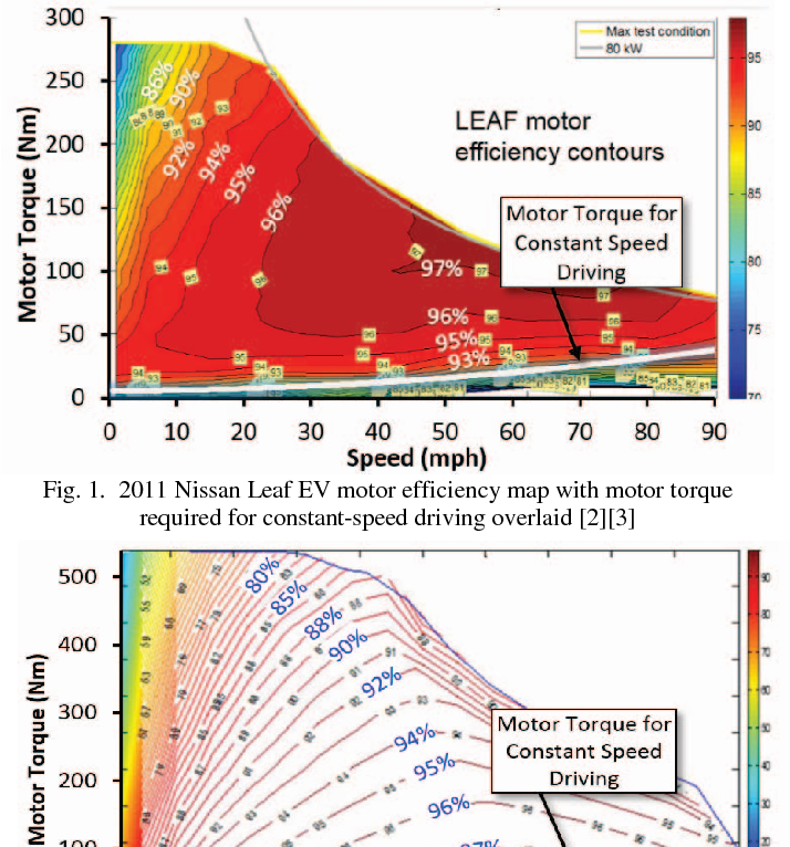

This is a LEAF motor efficiency plot. Its pretty easy with a single speed to stay above say ~94% for your whole race once the vehicle is moving.
I am impressed by how efficient the LEAF motor plots out. Even at low speeds and high torque, it is over 90% efficient. I have not been able to find an efficiency to current plot for the Astro Flight 3220 4 turn motor we are running, but I am pretty sure it falls off much more, out of it's happy zone.
