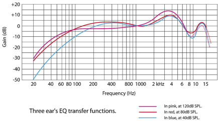

In general geared hubs are designed for larger wheels and will be a lot louder in a 20" due to a higher pitch noise ( human hearing perceives higher pitch noises up to a point to be louder )

It's interesting about higher pitch noise being perceived as louder. On the G020 motor I do notice it is louder in the 20" wheel vs the original 26", but not overly so. The problem I had with the 26" wheel was that the trike had rear suspension. With the weight of the hub motor out on the end of the log swing arm it effected the suspension operation. But even more so, it introduced too much flex in the rear, especially when cornering. So much so it became dangerous at higher speeds. I don't have that problem with the shorter more rigid 20" wheeled trike.
