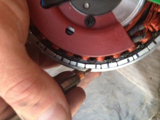

I checked continuity of the whole hall sensor loop. I checked continuity of all wires coming in and out of the controller. I opened up the motor and didn’t notice anything special.
The only thing I noticed were some of the small black plastic stuff between the magnets in the motor sticking out. I don’t know whether I can or should push them back into alignment.

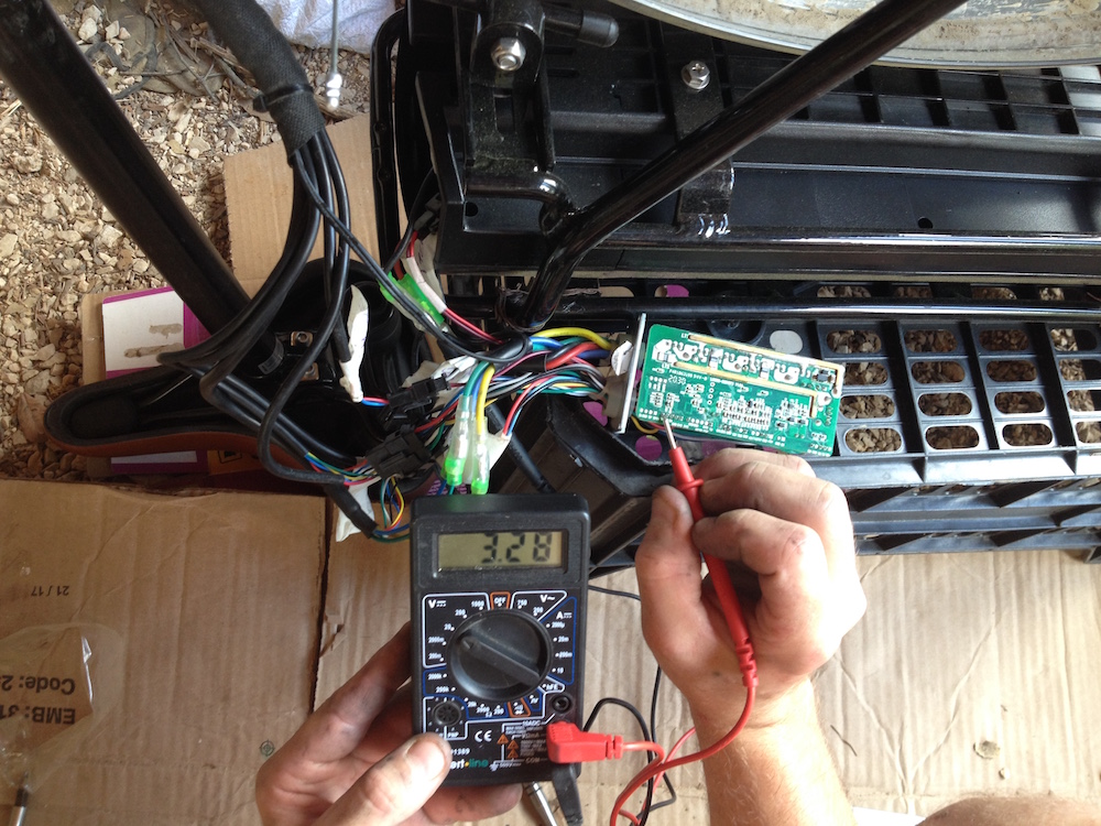

I also wired everything back together, with controller still open, and measured voltage on each hall sensor wire solder, turning the wheel a little bit each time. Voltage oscillated from 0 to 3.28 V alternatively, looking perfectly normal.
Thus it seems to me that the whole hall sensor loop is working perfectly.
Unless it behaves differently with the controller put back into place, and the bike moving.

10. I checked for loose magnets
I don't know whether my check was sufficient. I used a small screwdriver and tried to push every magnet towards the center, but lightly, and without separating the rotor from the stator:
I didn't notice any movement.

I suspect the controller, since you said you did the electrical tests on the hall sensors, apparently right on the circuit board, but you haven't ruled out a fault in the cable. motor connector and upstream onto the controller. You might consider just giving up on the analytics and throwing money on a new controller/display, gambling that it works. Or find someone willing to plug the motor into their working controller to show whether the motor is suspect,
The motor noise vibration is not there when the bike starts normally, and then appears if it restarts? No noise if you stop and then start again? Suggests you've got a bad connection to the Halls or a bad Hall. .
You have a lot of energy, taking the whole motor apart. EVen spinning it without the housing, I admire that, but I don't think you have enough gear to test this problem.
Thanks a lot for the reply!
Are you referring to the troubleshooting in general, or to my latest experiment? In my latest experiment, I unplugged the phase wires, and to make sure there is no wire issue from the hall sensors to the controller, I made sure to measure voltage on each hall sensor wire solder point during 10 seconds while turning the pedal, before measuring phase wire solder points. That way I wanted to be sure that the signals from phase wires are stable, and could not be a cause of change of phase wire output voltage.

I recommend you find out why your hall sensor output signal patterns are different between your first and second testing.
I.E. One on, two on, one on, two on, ect… is the correct pattern as in the first test.
