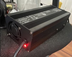

I have removed battery from the bike i like to charge it in office

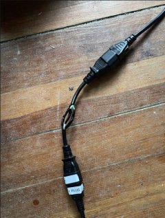

i created cable, it was pretty easy, using PC cables now it seems is charging,
How do i add display to see how many volts already charged?
now i have solution charge it for 1 hour then manually test after i have disconnect charger using multimeter :(
is there any better charger advice? with status display?
Please advice!
Thank you!

I’m spoiled with a Bluetooth BMS now, but you could get a Bluetooth enabled multimeter so you can check the voltage remotely using your phone.
what model i need it? where to order it? this square batery 72v it probably already have BMS, i have chaget my mototech plugin directly to the bike and this same charger RED when was charging and green then is full. ill keep chaging like for 2-3 hours and see happened maybe charger will stop autumnally...
wow it automatic stopped and charger show GREN light!!! awesome!!! be careful always measure polarity!!
