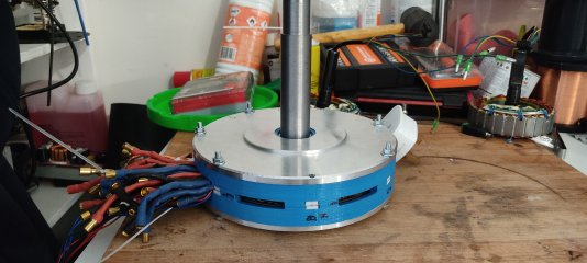

Being a flat design, stacking is good option for multiplying power capabilities here is my first design with 3 stator and 4 rotors :
(spacing messed up because of later part revision for another assembly)
This particular design, with single magnet thin inner stator, after motor constant calculation proved itself to be not much better than a two stator design with two magnet thick middle stator. This is mostly due to too low magnetic flux through the middle stator. Here the axial flux density through one pole with previous presented design and after the one with the double magnet center rotor :
The later version will be chosen because the first stator prooved itself to be time consumming to manufacture to say the least :lol:
A prototype is beeing build and I will share with you the state of it and the building technique used in a later post. It's coming quite slowly because of a lot of reasons (covid induced shortage on material/time lacking/me just being lazy/being a beginner machinist :roll: )

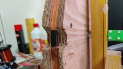

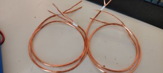

750 parallel strand is pain and after some thoughts here is how I did it :
The wheel has a slot as wide as the one in the stator and has a 1m perimeter. With the handwheel it take approximately 10min to do the 750 turns.
after that the copper is glued with cyanoacrylate based glue (to avoid wires being pulled in the later step) and tape in a notch in the wheel then cut :
Once cut it gived me a mess of wire that was kinda hard to work with so i find the solution of wrapping it with a single enameled wire wich actually gived a satisfying phase bundle :

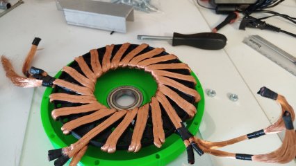

5 bundles later and here we are with the winded stator :
the stator carrier isn't ideal, switching from one side to another i modeled an axial path wich was the easiest in CAD but when winding wasn't the natural direction the wire wanted to take. It lead to some wire passing over and not wanting to stay in the slot
Next time i'll make that pass follow the skewing angle (it will slightly increase flux linkage so that's a good thing):

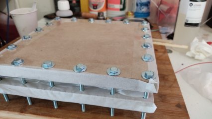

I then proceed to impregnate the winding with HT epoxy resin and squeeze it between two glass sheets with the help of a mdf "press" to keep it flat and as thin as possible :
I ended up with a 10mm stator thickness instead of the 9 i was hoping for because of me beeing optimistic with copper fill and the carrier problem mentionned previously. If I can reduce the rotor-stator clearance to 0.5mm instead of the 1mm i was planning on we are good, if not the airgap will be increased and Kv further increased.
After 16 hours of cure time at ambiant temperature the stator is then post cured at 60°C for another 16 hours. This will bring the epoxy to it's rated glass transition temperature of 115°C. Laking a heat controled oven, i did it on my 3D printer heated bed with insulating sheet on top to limit power consumtion :
For watercooling the next step would be to lay a fiberglass cloth on to close each individual pockets but i'll keep that for later. As it stand the stator is rock solid, I feared that a vacum would have been needed to make the epoxy (wich is quite thick) impregnate the strands good but it appears that capilarity is slow but eventually does it thing (even to much since it has found his way through the short ends of turn further that i expected, should have tin them first ... Now I hope I can do it anyway).
Each 1m turn has 100g of copper, the 3D print is 40g and 40g off epoxy gives a 680g stator (feels substancial)

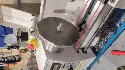

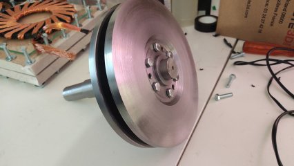

Now for the rotor building, due to shortage of stock (covid19) I had to buy some not ideal steel plate and do a lot of cutting to fit it on my small lathe :
(sorry for the machinists out there, i know the stock mounting is sketchy, but whatever it take to get it done right ? :lol: )
After a LOT of passes :
Magnets will later be glued to it using the same HT epoxy with a bit of thickening agent I supposed (I have not really looked into heavy duty magnet securing. The rotors has a 4mm machined lip so I supposed i'm good with centrifugal forces but who knows at 15000RPM what could happen :?
The second rotor is almost finished as well as the aluminium spacer (just needing parting at length) and the axle too.
As a firts test, since I haven't received my aluminium stock (2 months since I ordered it :evil:), I have 3D printed some outer shells and will test to see what it does with a single stator pretty soon I hope (Kv should be 300).
That 4mm lip on the rotor will be forming a magnetic bridge at the ends of the magnets. If you're planning on 15k rpm then you might have to live with the outer one but the inner wouldn't be hard to correct, I doubt it will be well enough balanced for 15k rpm though, usually even professionally CNCd parts would need some balancing for those kind of rpms.
The face the magnets mount to could probably benefit from a fine facing cut too, it looks like there's a step there. If you're having trouble with swapping tools for the inner and outer corners, you get used to it with practice but a bit of cigarette paper on the face you're trying to match up to can help. Damp the face, stick a bit of paper on and when you bring the tool up until it touches the paper it will be somewhere around 0.001" to 0.002" away from the face depending on the thickness of the paper.
No worries on pulling it into the chuck with a bolt btw, I'm not sure about "approved" practice but it's certainly common practice ;) Usually you'd machine a mandrel for the centre hole out of a bit of scrap bar and maybe add a drive dog. Worth playing around with centre mandrels, they're the usual method of accurately machining bored parts with a 3 jaw chuck.
Actually haven't tough about that at all :shock: ! Maybe reducing the lip heigth to half the magnet thickness will be sufficient for keeping the magnet from flying and cut the bridge ?
I don't think i'm going to cut on balancing for sure, static first and dynamic if needed (but for that i'll need an osciloscope and some IMU). The two stators version is expected to run at 8-9K max so a bit more realistic.
Yeah it was shatering pretty badly when doing this cut, to much leverage from where the 3 jaws was holding and 5mm start to be a bit too thin to have enough rigidity I suppose. There is a step of 0.5mm near the center but it's there mostly because of me changing my mind during the cut between having a 5mm deep groove or having a 5mm back iron (as I should), and that because my stock beeing 10mm thick for a 10mm machined dimension :roll:
The next one is a bit better in that regards, I started with the face groove when the part still had rigidity and it went much better.
No worries on pulling it into the chuck with a bolt btw, I'm not sure about "approved" practice but it's certainly common practice Usually you'd machine a mandrel for the centre hole out of a bit of scrap bar and maybe add a drive dog. Worth playing around with centre mandrels, they're the usual method of accurately machining bored parts with a 3 jaw chuck.
Good to know :)
That's actually a better way for sure ... That way everything is concentric with the bore and true to the first face reference. I just can't figure how would you fixtured the part for machining the bore in the beginning ? maybe a fixture plate ?
I plan on truing everything once mounted on the axle before gluing the magnet to increase my chances of having it balanced.
Repeatable too, if you need to take the workpiece out it can be re-mounted with everything still centred. Usually you'd use a faceplate for the initial bore, a flat face with slots for clamping. I was going to say one would be worth getting if they're the right price but in all honesty it's usually years between uses here, they're good to have but they'll spend most of their time gathering dust. The easiest option is probably to temporarily weld a piece of heavy tube or drilled bar to the back and cut the welds after boring, if you're facing both sides then distortion shouldn't be much problem.
Another option you rarely see used these days is to mount the workpiece to the saddle, tool post or wherever convenient and put the drill in the chuck. Usually the spindle has a morse taper, mostly that's just used for turning between centres but there's no reason you can't use it for a drill chuck or other tools, lathes being used for milling operations used to be common practice. Adjustable boring heads are a great thing to have if you go that route, not crazy expensive and they're ok as fly cutters for facing. Adjustable reamers can be worth getting too, with practice they give very good results.
Not sure what would be the best option for dealing with the chatter, didn't realise it was that thin! A faceplate would be a big help to you there, pull the workpiece up against it either with a drawbar or revolving centre in the tailstock and it's a solid face to work on. If you think you'll be doing a lot of thin, large diameter parts then it could be worth considering one but you could knock something up for one-offs, maybe a disk of heavy plate welded to a bar or an old car brake disk, etc.
Could be worth trying those magnets before doing anything about the bridge, you could get some solid figures on what kind of effect it has before and after.
I actually did use your advise to true up the seconde face of one rotor, mandrel is the way to go for this :thumb:
Actually the lathe even if it's kind of cheap for this kind of tool was a lot of money to spend on a hobby like this for me, it might be a while before I pull the trigger on big accessories like this (might even not be worth it like you said, even more for this low quality chinese lathe). When I'll get a welder this trick will for sure be used :lol:
I was actually planning on doing something like that to mill keyways in the axle, but it's to much work for a prototype and the probable small torque I will get out of this. You are mentionning a lot of cool tools I will surely want sooner than I think !

But i've managed to finish the rotor machining :

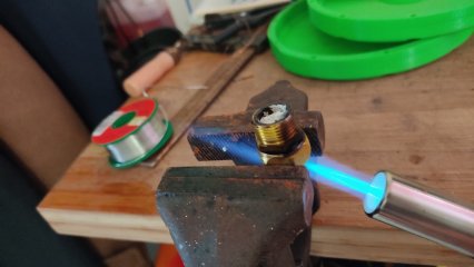

I also have dificulties soldering the enamaled copper wire even though it's the "solderable" kind. I can solder a single strand with my soldering iron but when putting a few strand twisted together in a makeshift solder pot nothing happen even after a few minutes. here is how I tried to do it :
Maybe the temp is to low but seeing how the flux is turning black I don't think so ... Any ideas ?
Plumbing flux, most hardware shops will carry it. A good polish first with wire wool, emery, scotchbrite etc followed by a good smear of flux and it should tin easily, that torch will have more than enough heat.
Good job on the rotors :) Looks like the indexing came out well on the bolt holes too, always a pain to get right by hand. Not sure if that lathe has any gears driving the headstock, might not with the variable drive but if it has they can be used as a basic indexing head, just needs something to lock between the teeth. For ex, if it has a 24 tooth drive gear it can index every 15 degrees, score a mark with a tool or even make a mount to put a hand drill in the toolpost, ymmv with the accuracy of drill bearings and rigidity of the body but it can often give very good results.

A good paint stripper will take enamel off after a few minutes,.. could be another thing to try?
First off, this looks awesome. I really like you method for making the multi-strand bundles.
As far as the wire enamel goes. I found that color enamel is typically polyamideimide. I have not found an easy way to work with it. I found that a lighter will cook it off, but too long and it will melt the wire. I found that using a weaker enamel was worth the trouble it saved. If you do figure something out, I would love to switch back to that type of wire for the improved heat tolerance.

Getting back on the build itself, I never got the first stator phases to tin properly and decided on building a second one, this time with splitted individual length of 236 stands each. here find some pictures of how it had gone :
This time learning from previous troubles I pretined all terminaison before winding. But as you van see on previous pictures I still got troubles tinning 236 stands tight together at one go, the cotting seems to tin very good on single strand but when tight together I suspect the heat being wicked away to much. Having the tin to hot seems also to put the vernish on a "ccoked" state sligthly brown and it is then not solderable at all. I got away some time with the right temp tin bath (I have a cheap solder pot now) and preading the stands help also a bit.
I tighten the press a bit to much this time and the glass didn't survive. I need to find stronger material to replace the mdf board.
I machined the casing pieces out of 10mm aluminium plates. But have taken them a bit to thin and not as rigid as I would like. Also I haven't found suitable stock to do the outer parts so they are 3D printed for now. I don't want to machine this on a big aluminium block because of cost and all the lost material. For the final parts I might try to cast and them.
On this stator I took 75% of the initial stand count to be sure to have it to the right thikness once pressed. The split individual turn length is so that I can configure it either as a 3turn/phase ore 6 turn/phase. for indivual testing or multistage connexion. It inevitably ended in a mess of wire once connected :lol:
I had some issue centering the stator inside the rotor but enventualy got it right with 3d printed axle spacers. I hot glued the hall sensors inside the cavities between phases and the glue was what was draging.
It is now turning freely and I got it running with a Vesc 75100.
Detection come out as 70mOhm and 10uH, I got it to 19825 ERPM (so 2832rpm with a 7 pole pair rotor) with 70% dutycycle and a 23.5V battery. If I'm correct that's around 170kv. It's a bit higher than the 120 I got with a test 6 turn stator. I suspect this is because when guing the magnet I did'nt got them perfectly lined up with my previous bolt placement and the magnet are a bit skewed. This should be fixed by elongating the rotor bolt holes.
As of now I haven't got it to properly start sensorless, it just wondered back and forth. With hall sensors it run quite good, until the transition point to sensorless were, if the current is to high, the vesc throws a ABS overcurrent code. I will post a video showing the motor running and this issue soon.
