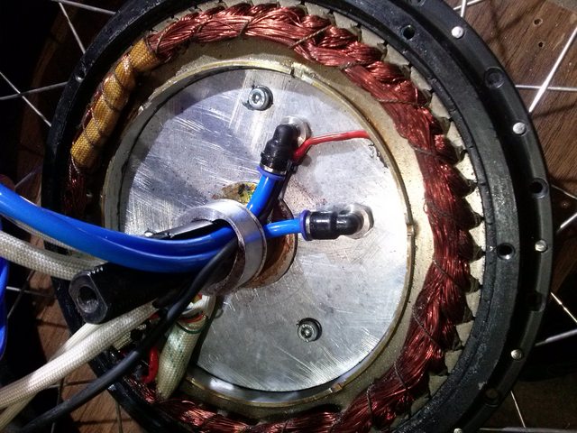

Hi Macribs,
This is a version 1 motor that was part of the US group buy handled by Teslanv.
I am still trying to decide what the best adhesive will be to thermally connect, "not electrically" the copper loop to motor stator. Any recommendations will be greatly appreciated. I am sure there are many options out there that could serve this purpose. I will probably use some type of CPU or even possibly a small dirt bike radiator, but I am not sure if these are made from aluminum or copper, but you do have a good point here. I think if I use a good radiator fluid like for automotive use there are corrosion inhibitors within the fluid that should minimize this problem, but I will look into this before making a final decision.
Currently I my battery is only a nominal 48V 30aH pack in a 16s2P configuration. When fully charged about 54V. I would like to bring to a 72V configuration, but this will need to wait until after I finish the motor mods due to funding. My problem is I have a 20 mile ride to work one way that includes almost a 1000 ft of elevation gain during the ride. I had a Crystalyte motor that I had fried after a little more than 1800 miles. I was going to rewire that motor with a higher temp wire and try to add cooling, until this motor came along. Here is the link so you can see what happened to that motor and why I am doing this. I probably, "as many people would state" had the controller tuned to drive too much current/power to the motor, but where I had it tuned it worked very well, especially on hills. One of the problems was I had my block time set to more than a second so the peak wattage at many points would run up to 2600 Watts for more time than was appropriate for this motor, which is way too much for that Clyte motor especially when driving 20 miles constantly at 30 MPH plus. I am hoping, with a combination of this new motor being more beefy to start plus the cooling, I should have no problem with overheating and can hopefully pull 30K miles from it.
I am going to run with no fan to start to try and cut down on the required power. When sitting at a light the motor should not continue to heat up and just the action of the liquid pumping through the radiator should still remove heat from the motor. I may decide later to include a fan. I was thinking of possibly running the pump to a comparator circuit that would monitor the temperature of the motor and only kick on the pump if it got above some preset temp. I may first just include a switch, but I am changing things as I go along here.

here is CAD drawing, it is simple with no accurate dimensioning, this axle fit to V1 motor, I do not know if it fits to V2 because do not have it. as for cooling, I made some cooling modifications for middle version of cromotor, or better to name it manufacturer name: QSmotor, it have very similar aluminum stator part and here is how I modified it to liquid cooled :
it stator is little milled to make small corner and on it in both sides added aluminum laser cut sheets, all corners are sealed with engine class silicone, and both sheets are fastened together with 3 screws. to make liquid circulate each (one is not milled that is from one to other pipes to circulate round the stator) of stator legs have small grove to make space to aluminum cover. this design works ok, just at first needs good bleeding, it works better than mxus v1, but cost more and are more sensitive for bleeding.
