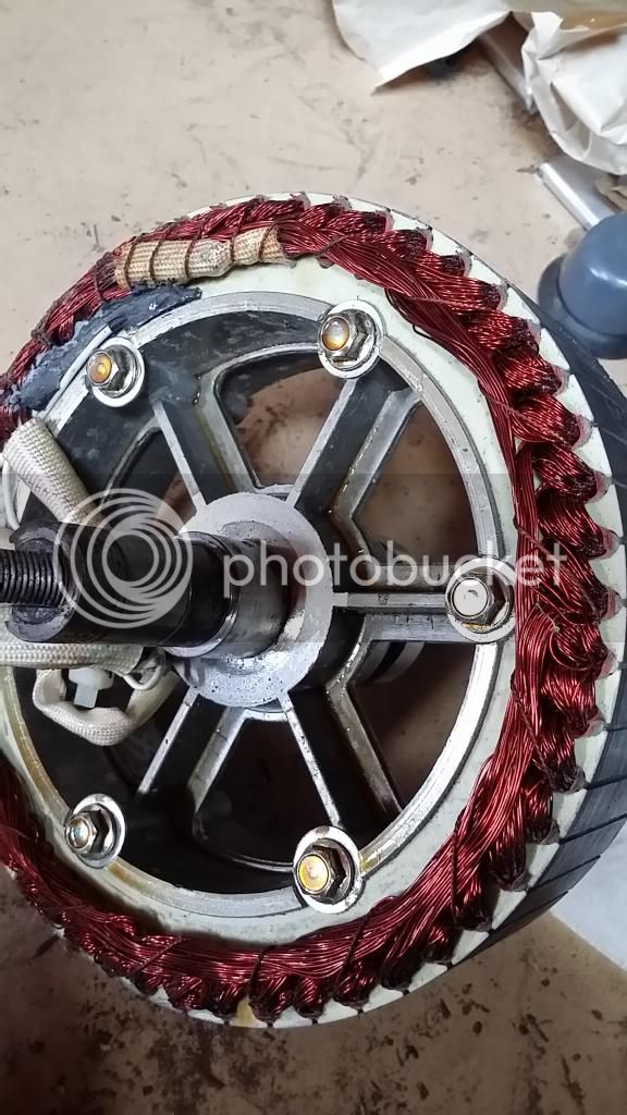

little miss understanding: I meant hubmotor, just as I know there was 3 stator versions, 1v was with stamped steel stator, 2v and 3v with aluminum, here is how looked v2:
and this is v3:
to make liquid cooling quite easy for V2 is possible (but need to mill stator, so to offer kit without having motor stator is too difficult), but to V3 is impossible or cost too much.

3 extra strands and more than 25% shorter, so it should be significantly lower phase-to-phase resistance. It's difficult to gauge just from pics, but it looks like the Cromotor has stator steel with longer teeth, so it fits more total copper, but do they even sell a 3T? I saw your plan on using the 3T MXUS and it made sense to me, though I can't comment on the relative high speed efficiency since I've never used field weakening...never even boosted an Infineon above 100% speed...never needed too. :mrgreen:

The 4T is a 9.0 Kv motor, and the 3T is a 12.0 Kv Motor. The 3T has 21 strands of copper in parallel vs 16 strands for the 4T. This means that the 3T can take (21/16) or 31% more current than the 4T wind. The 3T will need the extra amperage to produce similar torque as the 4T, however, so your controller will need to able to supply enough current.
Wouldn't 21 strands be smaller diameter wire vs 16 strands?
Im confused on how they would get more copper in there
