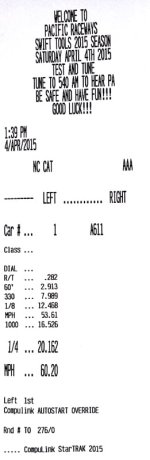

3T MXUS with upgraded phase wires, 21.5" Moped Racing tires, ~100V on my 18X4110 Infineon, 80A Battery, 180A Phase Current.

20.162 seconds for the 1/4 mile.
Reaction time of 0.282 seconds.
53.61 mph in the 1/8th.

Did you get a 60' time? 1/8th mile ET? Were you full throttle off the line or did you need to roll on to avoid wheelie? I was really hoping you would beat Doctor B :lol: Well done on the race and congratulations on cracking 60.
There's plenty more speed/power to be had with a better controller :) 120/300 @ 100v with one of the new generation sabvoton 96v units should result in slicing at least a couple of seconds off your ET
